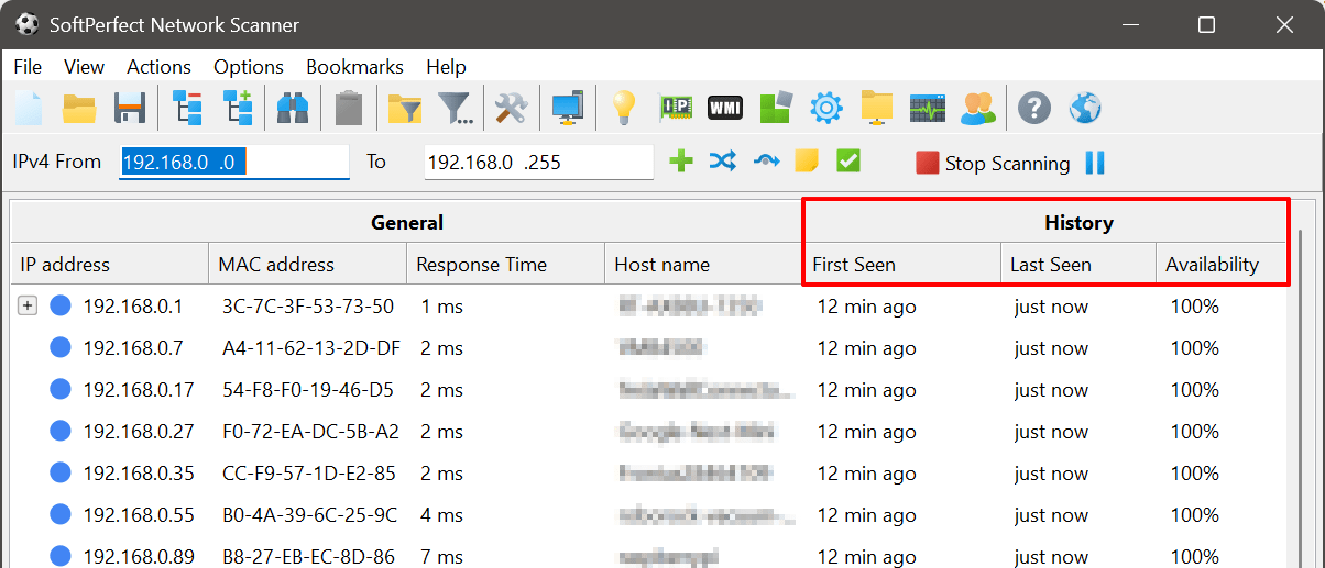

We've implemented history recording, in which every scan round records found devices in a compact form.
This easily enables simple first-seen, last-seen, and availability tracking (how many scans the device was online in).
Next, we plan to derive additional reports and insights from the same dataset.
Main grid columns (per-device, one value per row)
These are inexpensive to calculate, as they are derived directly from a single device's history in addition to the existing First Seen, Last Seen and Availability metrics:

If you have any ideas what else could be useful, please let us know.
