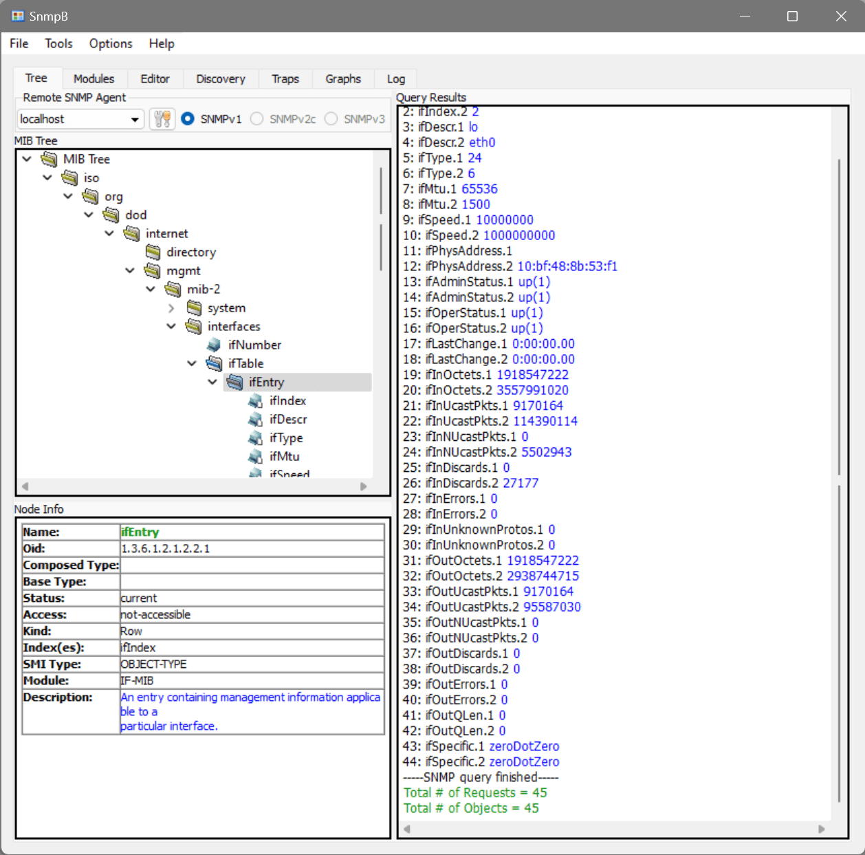

You can test it any SNMP browser, like SnmpB. Enter your switch's IP address and community and walk down the ifEntry OID. It will then display all the current interface details and statistics:

I tried the program you indicated, I confirm that it reads the 2 ports (8 and 9) correctly, that is without errors and discards.
To be sure that the program works I left port 16 with errors, and in fact it is indicated correctly.

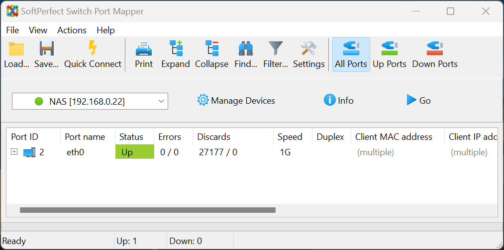

Here, I have scanned a NAS device that had a number of recorded discards on its port eth0:

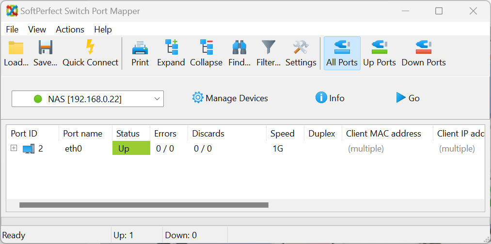

Then, I rebooted the device to clear the counters, rescanned it again, and the counters have been reset:
