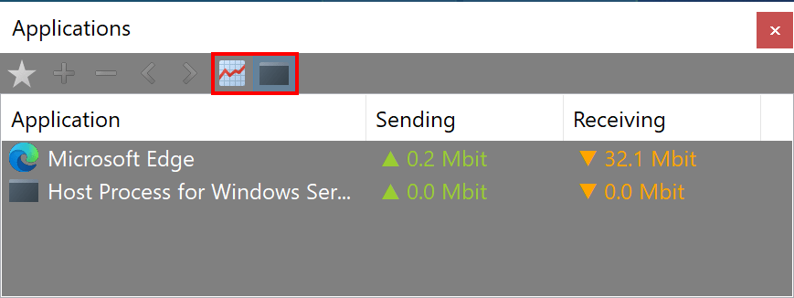

Real-time application information can be seen using the same graph window. Note the highlighted buttons that switch between graph view and process view:
This list is real time, but things disappear off it very fast, I think within like 15 - 30 seconds, so that's why I was asking for a Static list, like set a timer to 0, and it never resets, or be able to set it to 60 minutes or what-not as well. That being said, it seems your NetGenius program was more of what I was looking for, as it has that static app list, and also a bandwidth monitor. Wish it also had a list of connected ports for each connection too, but that's another forum I think.
A static list is essentially what you see under Usage Reports. Once an app exhibited network activity, it's shown in real-time view first, and then recorded in the database on a per-hour basis. So at any time you can go to the Usage Reports and see when it was active. We can add an additional hourly chart though, so you can see around what time an app transferred data.
