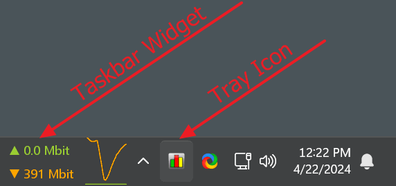

Re: How to display taskbar graph without numbers   04 October 2025, 09:40
You are probably still looking at the taskbar widget, whereas the setting highlighted in your screenshot refers to the tray icon:
