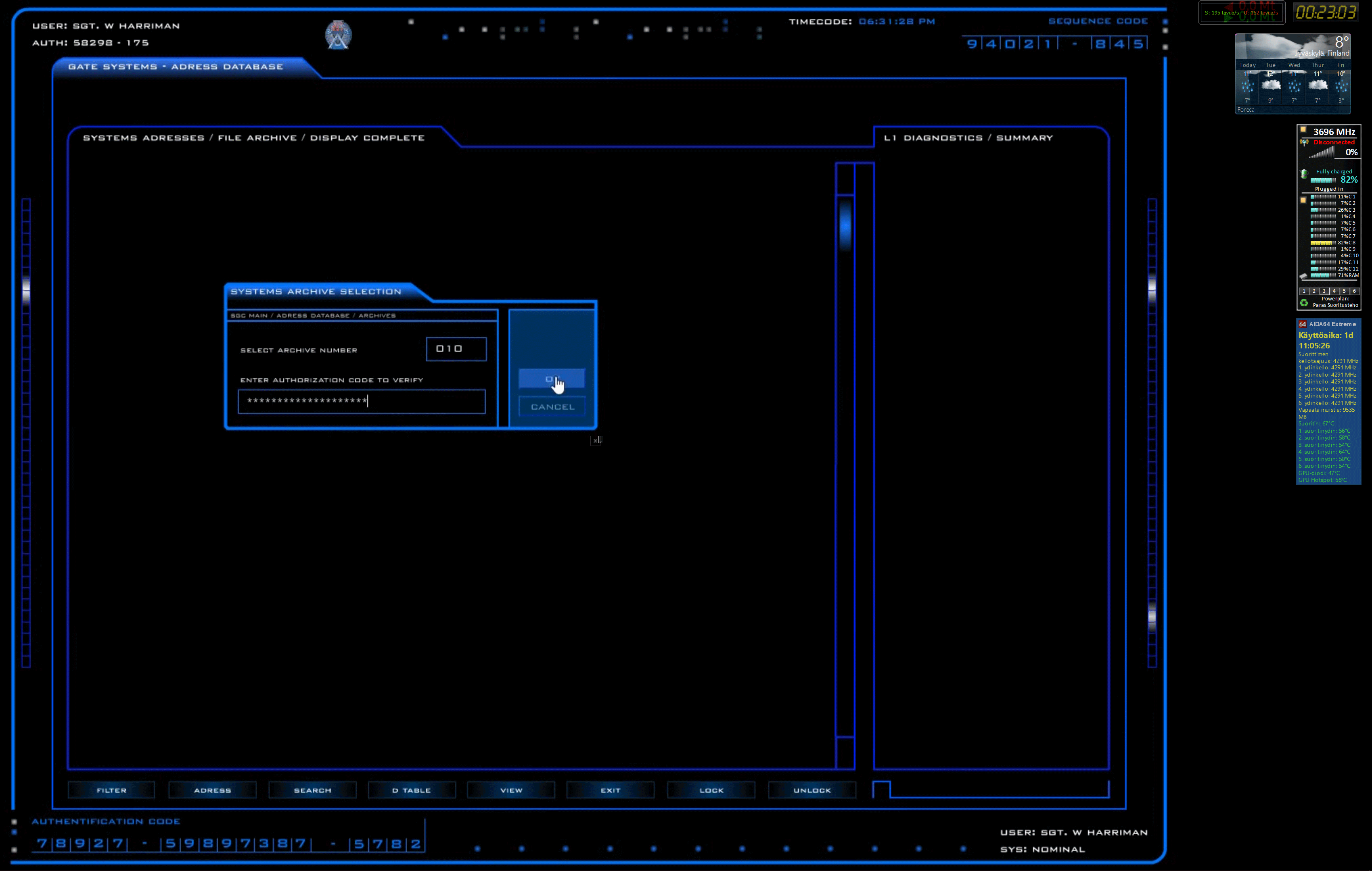

I added a screenshot of the issue with the old 5.5.5 running, notice how in the middle of the screen there is that small box with window borders and that X button to close it down.
Sure I have a Windows 7 Aero Glass theme with ultrauxtheme patcher running, but that has been the case for like since the days of Windows 8 with no issues. And unpatching, restarting and running the ugly flat Windows 10 theme did not help with the bug either.
So only thing that the Aero Glass theme affects here, is that the thicker transparent window borders make it more noticeable.
I can't interact with it in any other ways than small spots if it do make my cursor look like it could spread it open and that X does highlight as ifI could interact with it. But again it does nothing.
At least it will fall behind other open windows, but if I were to open it now, that box would appear on top of my browser. Tho as soon as I click on the browses and make it active, that box thing will fall behind the browser window even tho the graph is set and stays on top.
The box can be located in the centre of the screen, right under the "Cancel" button of the Wallpaper Engine wallpaper:

I'm not sure where that invisible window in the old version comes from, as no one else has ever reported it. Please try the latest version and let me know if it still happens, and under what exact circumstances, and we'll be happy to look into it further.

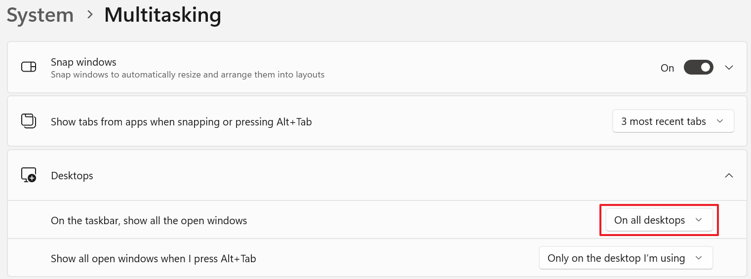

As for showing the graph on all virtual desktops, the old version wasn't really aware of virtual desktops at all, and the latest version isn't either. From what I can tell, this is controlled by a Windows setting. You can find it under Settings - System - Multitasking, where you can choose whether app windows appear on all desktops or only the one you are using:

This does not work, since I want the apps to stay in their own desktops instead of cluttering all desktops (even if just was the taskbar icon)
