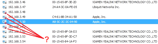

Computers marked with crossed red circle   11 March 2019, 08:55
In the scan results, some computer icons have crossed red circles on them. What do these red circles with a white "X" mean?
Thank you
Re: Computers marked with crossed red circle   11 March 2019, 09:09
The red circles mean there was an error while scanning those devices and the thread was killed. It could be a consequence of either:
  • The user clicked the Force button in the Stop Scanning dialog. This is not recommended, as it forcibly terminates the thread and results in a memory leak. Devices with terminated threads are marked with the red circle.
  • The user set a run-time limit in the settings, which lets threads run no longer than the set time period. For example, if the maximum run-time is set to 60s, after a thread has been running for 60s the application will attempt to finish it gracefully. Failing that, in double the time (120s) the thread is killed, likewise causing a memory leak and marking the device with a read circle.
In other words, a red circle indicates the thread was killed due to either of the above reasons.

Re: Computers marked with crossed red circle   11 March 2019, 09:23
Thank you for that.
