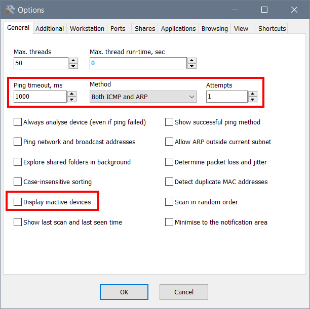

Hi there
I am scanning my C class network and don't know why not all devices are shown in the scan. Also, the number of scanned devices changes every time.
Please, let me know how to solve this problem.
Re: Number of scanned devices changes in every scan   07 December 2019, 15:29
From your message it is hard to tell what exactly you refer to as "problem", so please pick the relevant information below:
  • No MAC addresses are listed
    This can happen when scanning non-local subnet. See this article for details on scanning non-local subnets and getting MAC addresses.
  • Not all IP addresses are listed
    That would be because not every IP address has network device associated with it. It could also mean some devices are firewalled. Try setting the ping method to Both ICMP and ARP and tick Display inactive devices.
  • A different number of devices is found in each scan
    This can happen over time when some devices go off-line and new devices come on-line. To make sure all devices are detected, use Both ICMP and ARP method, and increase ping timeout and the number of attempts in the scan settings.
Here is a screen shot of the settings mentioned above:
Re: Number of scanned devices changes in every scan   28 December 2019, 09:48
