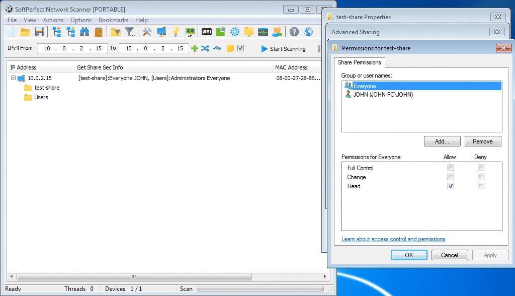

Admin Registered: 12 years ago Posts: 1 124 |
You will need to write a VBScript that extracts the list of shares, gets the security settings of each share, and then outputs that information.
Below is a sample script for getting share security info. You may want to modify it further to suit your needs, then load it into NetScanner via Options - Remote Scripting and, if WMI access is enabled and configured, run the script against your devices.
This will output the list of users who have access to each share:
