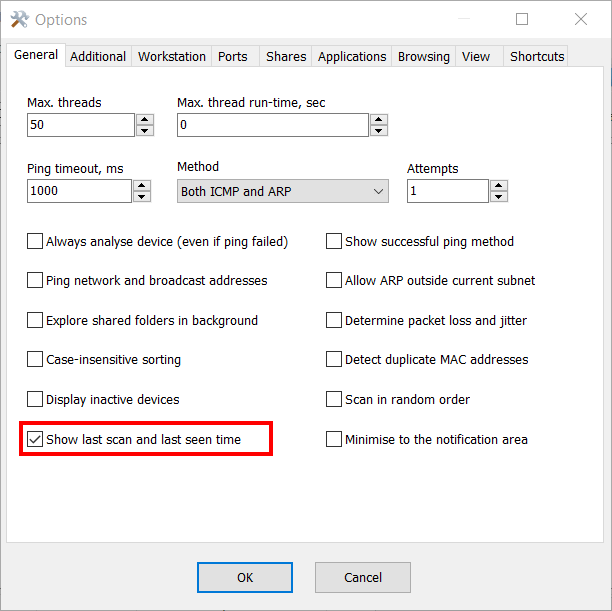

You can enable the Show last scan and last seen time in Options - General tab, as shown in the picture below. After you do that, there will be two extra columns with time stamps, which will be also exported to a CSV file.

In that case, still enable the Show last scan and last seen time option highlighted in the screen shot above, and optionally export the configuration to a file. Use that configuration file with your command-line scanning, and the 'Last scan' column will essentially be the time stamp:
netscan.exe /auto:"z:\output.csv" /config:z:\last-scan-on.xml
