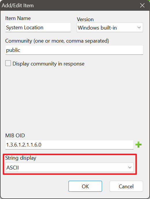

In SNMP, the OctetString data type can be used to carry both ASCII and UTF-8 strings, as well as binary data.
We've added a new setting that allows you to specify the string format in cases where the data is incorrectly detected as UTF-8. Please download the latest build, and select either ASCII or HEX for the EngineID to ensure it displays correctly:

Thanks for the quick update. I did tests with both ASCII and HEX option, but the issue still persists.
ASCII:
HEX:
With both options, the last two characters are still missing.
You can also see this when comparing the HEX-Values:
