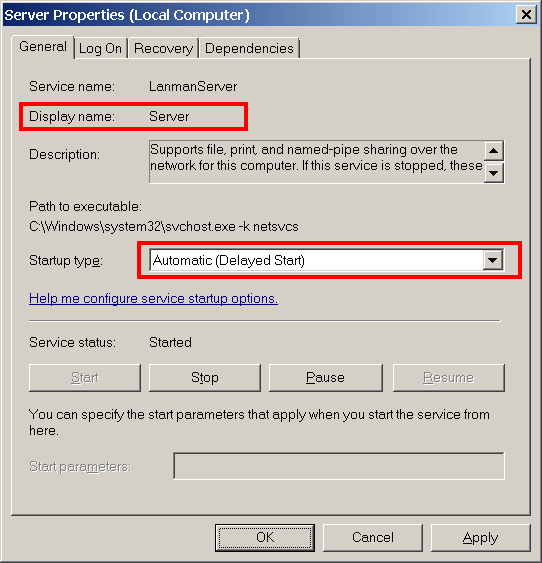

The easiest workaround is to change the Server's service to start delayed as shown below. Delayed start usually takes place within 2-3 minutes after boot, by which time the RAM disk should be ready.

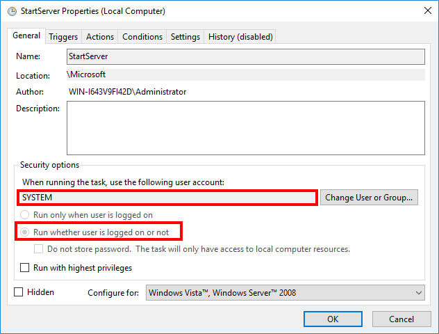

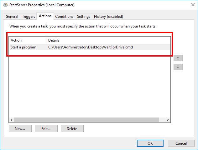

Below is a sample script. You would need to modify it to match your drive letter and create a scheduled task as shown in the following screen shots. The idea is to run the batch file upon startup and wait for a drive letter. Once it's available, start the service that depends on it.
