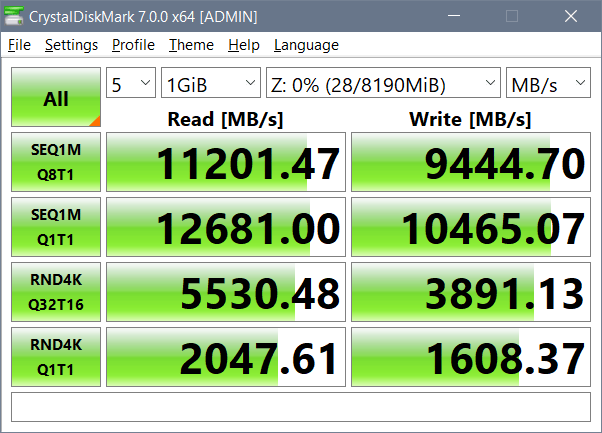

Sorry it's hard to predict what rates can be achieved on your hardware, so it's best to try it out. Please download a trial copy of RAM Disk and a tool called DiskMark.
Then simply create a RAM disk and run DiskMark against it. To simulate parallel I/O it might be worth running two DiskMark tests at the same time. You may also see better results with exFAT (less overhead than NTFS) and a larger cluster size (can be set in disk's properties).
All in all, depending on block size 5 GB/s sounds easily attainable. I got ~10 GB/s sequential I/O from a regular laptop:

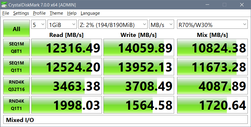

Does DiskMark measure concurrent access? That's really the key difference for us on this application, in that our data acquisition process will be writing to the RAMDISK at 5 GB/Sec and we will have to processes reading from the RAMDISK at up to 5 GB/Sec also, so we would need concurrent write speed of 5 GB/Sec and read perf of about 10 GB/Sec.
My gut tells me that with fast enough memory (and enough CPU cores) we will be ok.
By the way... thanks for making this product... I think it's going to be a lifesaver for us on this project.
Ross
Re: Concurrent read and write performance   11 May 2020, 10:00
It does actually: there are a few profiles and a "mix" mode where it reads and writes concurrently. It is also possible to adjust the ratio between reads and writes. In the screen shot below I tested a RAM disk with 70% reading, 30% writing. It only gets a little slower than reading and writing separately.
