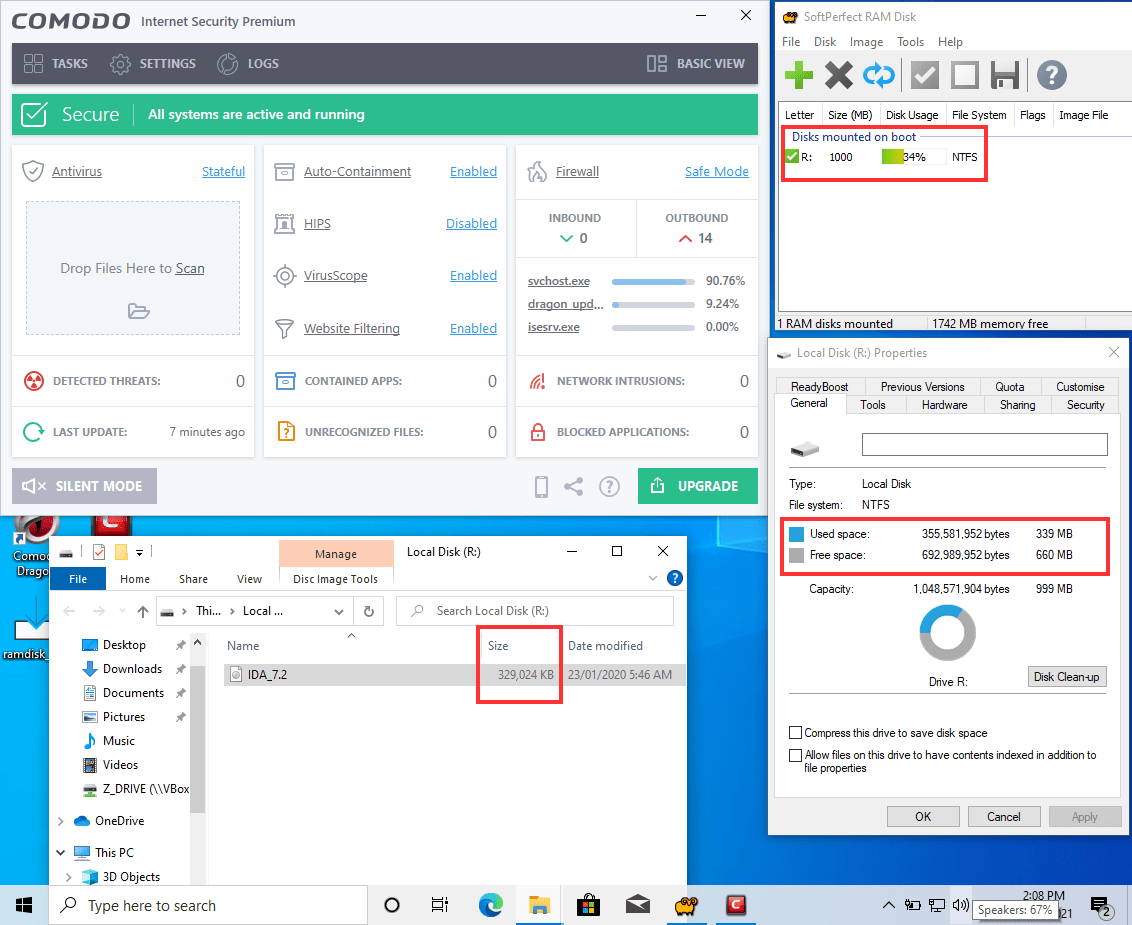

Sorry we were unable to reproduce this. We have installed the latest version of CIS and our RAM Disk, and copied a 300 MB file to a 1 GB RAM Disk a few times. The used disk space remained correct, as you can see in the screen shot below.
I guess in your case it may be caused by CIS antivirus that retains a copy of written data for checking, but it should behave the same way with any volume, even a USB thumb drive. It's unlikely to be an issue with our product since a RAM disk is a simple block storage device. It does not allocate space for files or anything like that, only emulates a storage device in RAM.

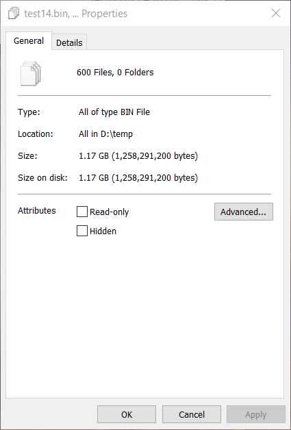

Try writing a large number of small files. In my case, 600 files with a total size of 2 gigabytes

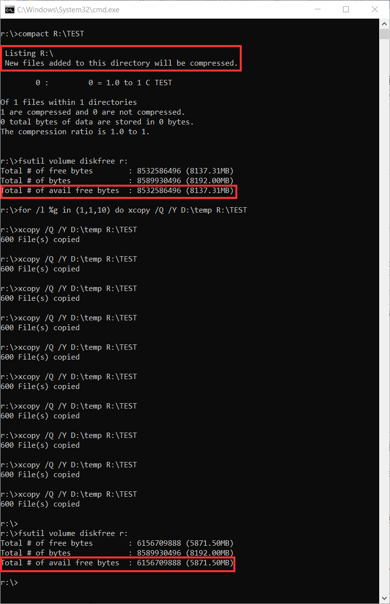

I am afraid this is not reproducible. Here is my test case:
Create 600 files 2 MB each with random contents totalling 1.2 GB

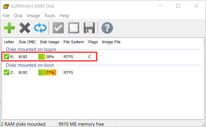

Create an 8 GB RAM disk with compressed NTFS
Copy these 600 files ten times from D:\TEMP to R:\TEST and query free space
There is a space discrepancy with 2.2 GB been used while the files occupy 1.2 GB but that's not unusual and not related to the problem you described. The reduced free space can have multiple reasons. One thing to understand is that free disk space will always be less than <Disk size> minus <Total size of all files>. This is because there is a lot of metadata which also eats up space like VSS Snapshots, MFT, logs and so on.
During compression of single files NTFS will temporarily keep the original file until compression has completed. This is to ensure that you still would be left with a valid version of the file in case your computer crashed. This however should only be temporary. Nevertheless everything points to NTFS metadata to cause this, not the RAM Disk.

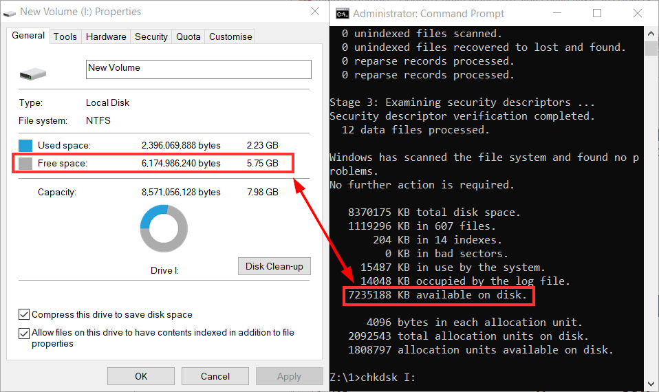

I have tested it with mounted VHD file as you suggested and encountered the same issue. In this test the I:\ drive is a mounted 8GB VHD file and there is 1.2 GB difference in free space reported in Windows Explorer and chkdsk output.
Microsoft has this article on NTFS disk space misreporting, but none of the points are relevant to our case.
I have come to the conclusion that it's not our RAM Disk's fault, but some kind of Windows bug or something.
Yes, I was wrong about AMD RAMDisk, I checked and there is the same problem. For some reason earlier I thought that there wasn't. Then I thought it happens on small disks. I checked, this happens on disks of any size, only on large disks this is not as noticeable. Free space is displayed correctly only after the disk is remounted. I think the topic can be closed.
