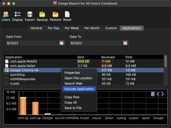

It is a common issue with VPN clients, because they intercept network connections from other apps, encrypt them, and then send them on within a secure tunnel. This is usually seen as network activity is correctly reported for other applications, and then the same activity is reported again for the VPN app.
The reason Bandwidth+ does not suffer from this problem is that it merely monitors a network adapter, i.e. how many bytes were sent and received. It does not analyse network activity by application. There is a monitoring mode in NetWorx that works likewise.
We think the best solution here would to add a way to "ignore" an app. So you would be able to mark the VPN app as "ignored" and its network activity will be disregarded. This will ensure the readings are correct.
We will add this feature shortly and post a link to the update.

Thank you for pointing this out. The latest build hides excluded apps from the real-time graph and the real-time app view.
