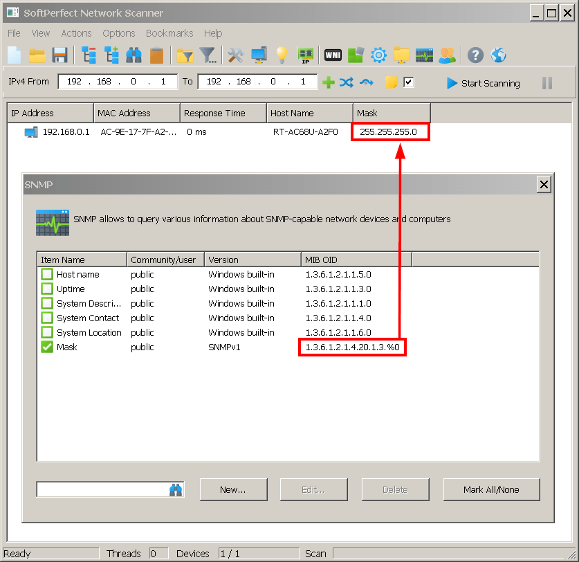

I am trying to use SNMP for finding the subnet of the scanned device. For that I need to use .1.3.6.1.2.1.4.20.1.3.{device_ip}
How can I use the IP of the scanned device as a variable and add it to the OID string?
Re: Using variable IP address in OID   07 August 2019, 23:07
This isn't possible in the current official release, but it has been added to the latest preliminary build.
For IP address and MAC address substitutions, use the following in OIDs:
  • %0 for IP address bytes
  • %1 for MAC address bytes
If you wish to use this feature right now, simply download the latest build, add 1.3.6.1.2.1.4.20.1.3.%0 as your OID, and the Network Scanner should retrieve the network masks.
Sharon
Re: Using variable IP address in OID   07 August 2019, 23:17
Thank you very much, it's working fine now...
