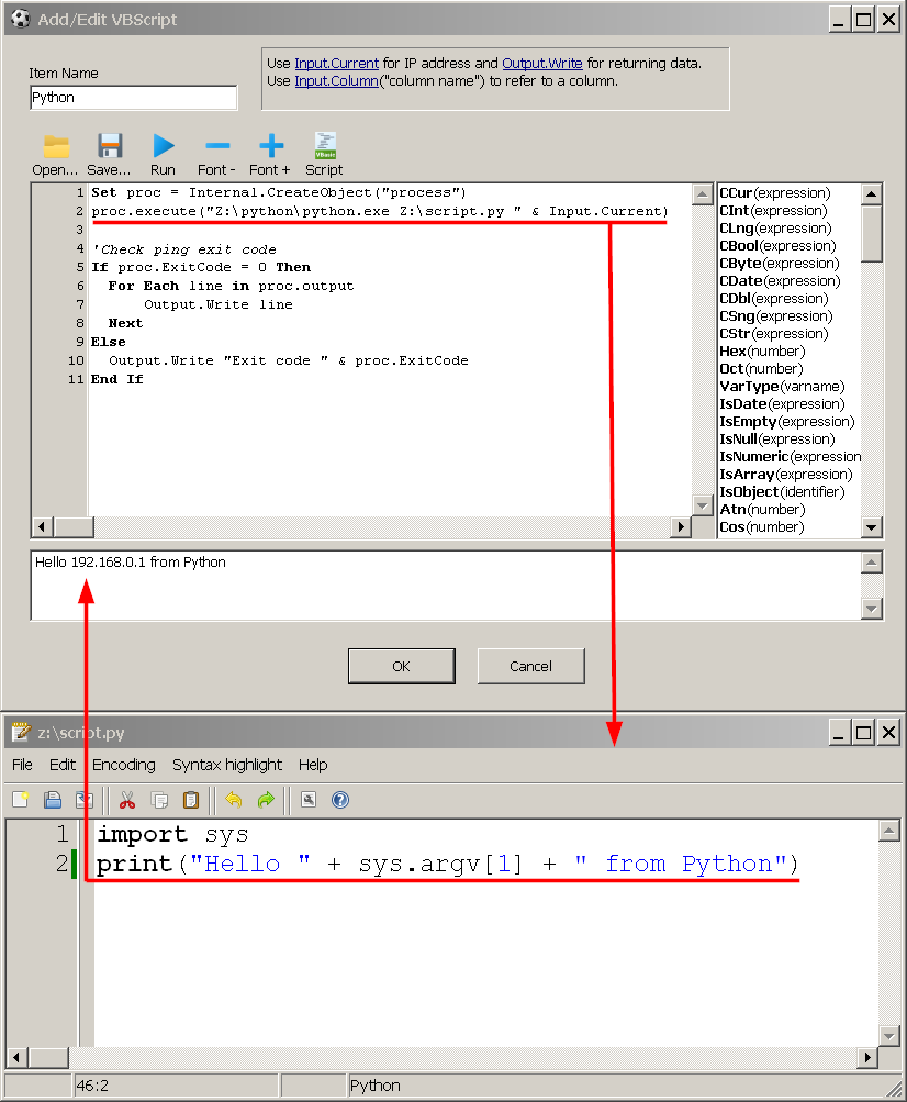

I saw that there is an option in SoftPerfect Network Scanner to run a remote VB script. Is there any option to run a Python script for each device?
Re: How to run a Python script   06 November 2019, 11:16
Although there is no direct integration with Python in the Network Scanner, you could call the Python interpreter from a simple VB script as shown below.
It will basically launch Python and pass the script name with any arguments, like the IP address. Anything that the script outputs will be captured and displayed in the Network Scanner.
Sharon
Re: How to run a Python script   06 November 2019, 11:23
It's working!!!
