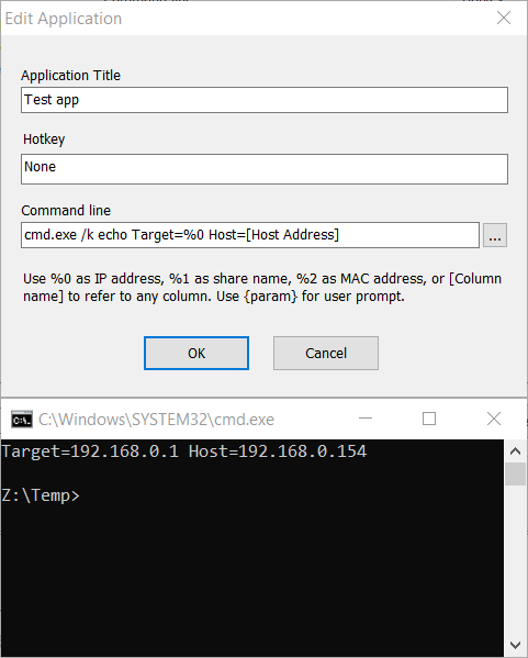

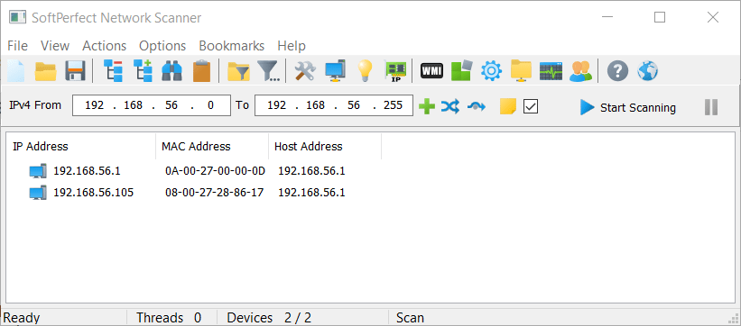

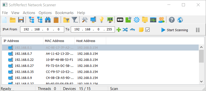

We have played with this a little bit and found it was easy to obtain host address without any changes to the application.
It can be simply done with the following VBScript:
Here are some examples. Like yours my PC has multiple connections (192.168.56.1, 192.168.0.154) and you can see a suitable IP is chosen:
You can use this address when launching applications by using [column name].
