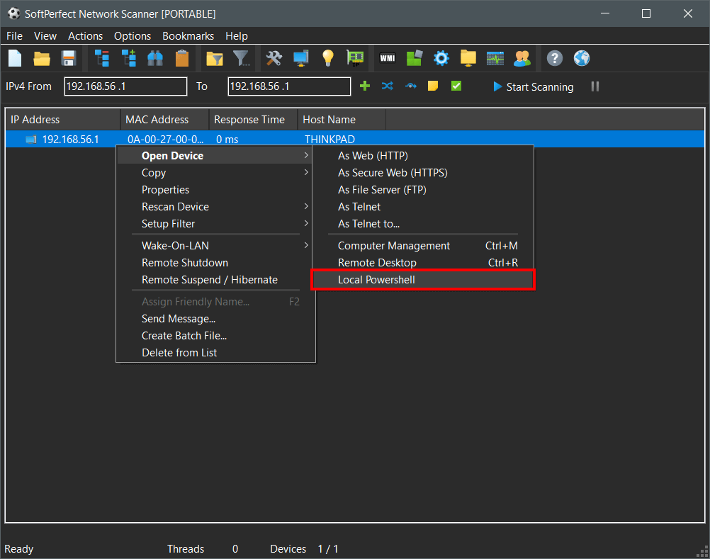

Could you please clarify how you'd like this to work?
At the moment, you can add this command to the list of applications (Options - Applications), and it can then be executed against any host name (via Open Device context menu), as shown below.
Did you want something different?
