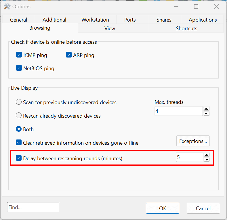

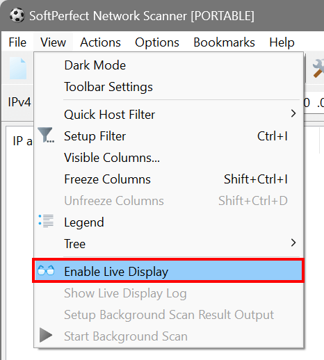

How do I schedule the automatic scan to run every 5 minutes?
Re: How to schedule automatic scan to run every X minutes   24 May 2024, 21:11
See View - Enable Live Display in the main menu, and Options - Program Options - Browsing - Live Display - Delay between rescanning rounds, as shown below:
