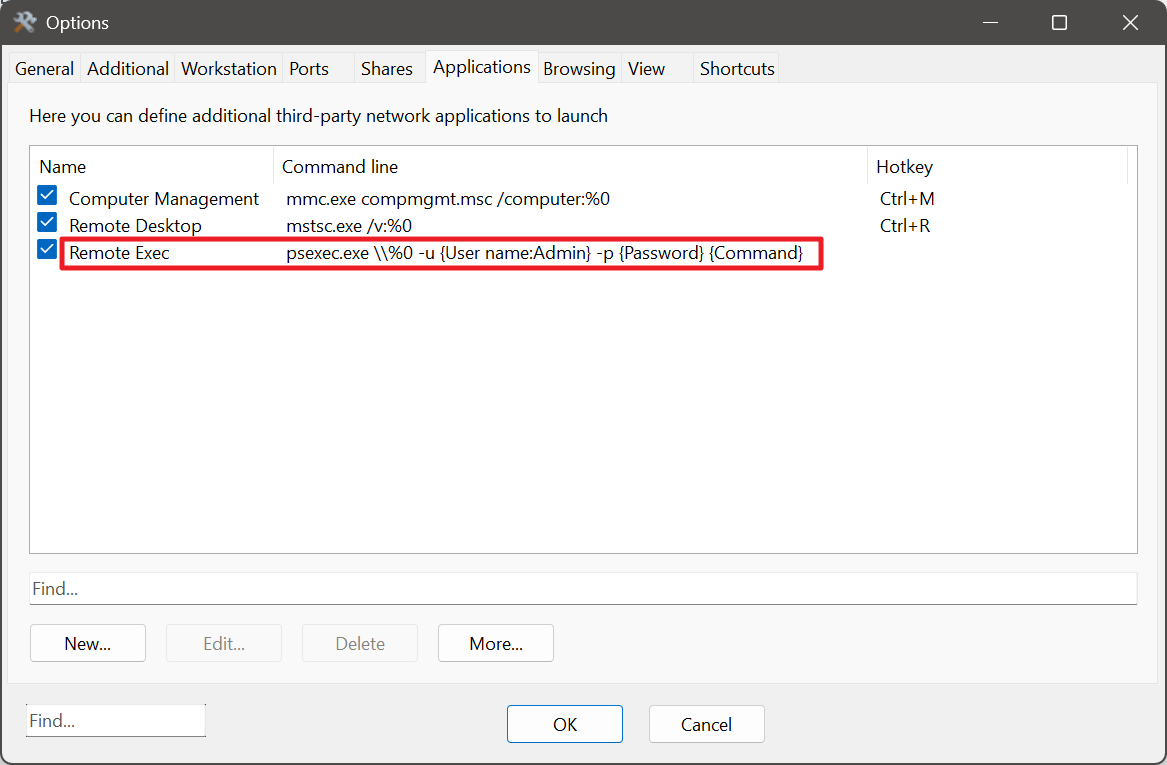

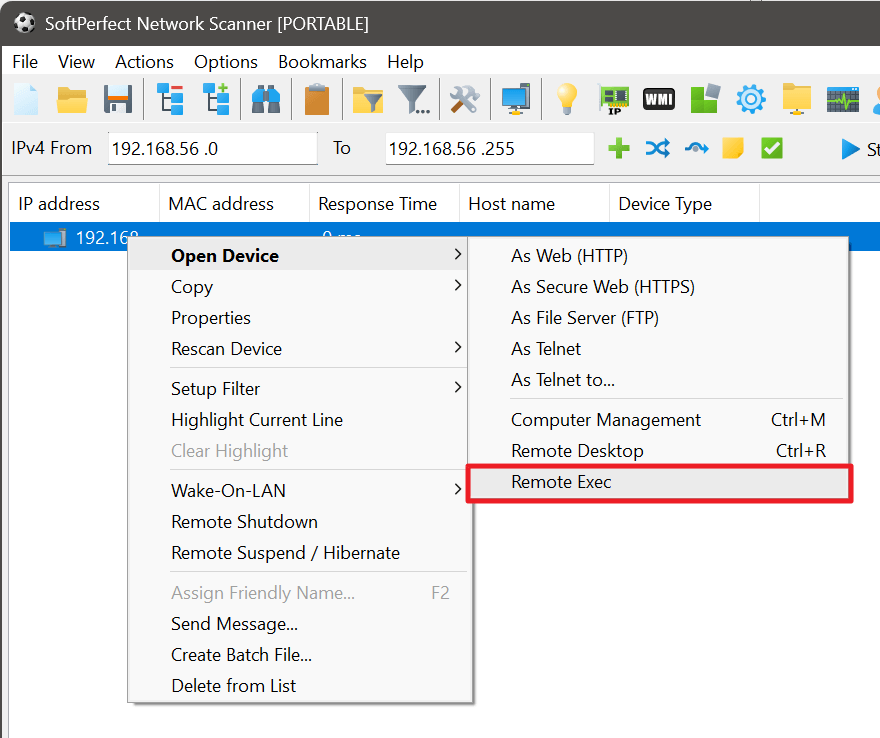

Your suggestion for a remote execution tool is interesting, however the Network Scanner already supports launching third-party applications, including:
  • PsExec - for running commands on Windows machines.
  • SSH - for executing commands on Linux/Unix devices.
As these tools are already integrated, you can execute remote commands on selected machines without needing a separate built-in remote execution feature. Below are a couple of screenshots illustrating how to do that.
