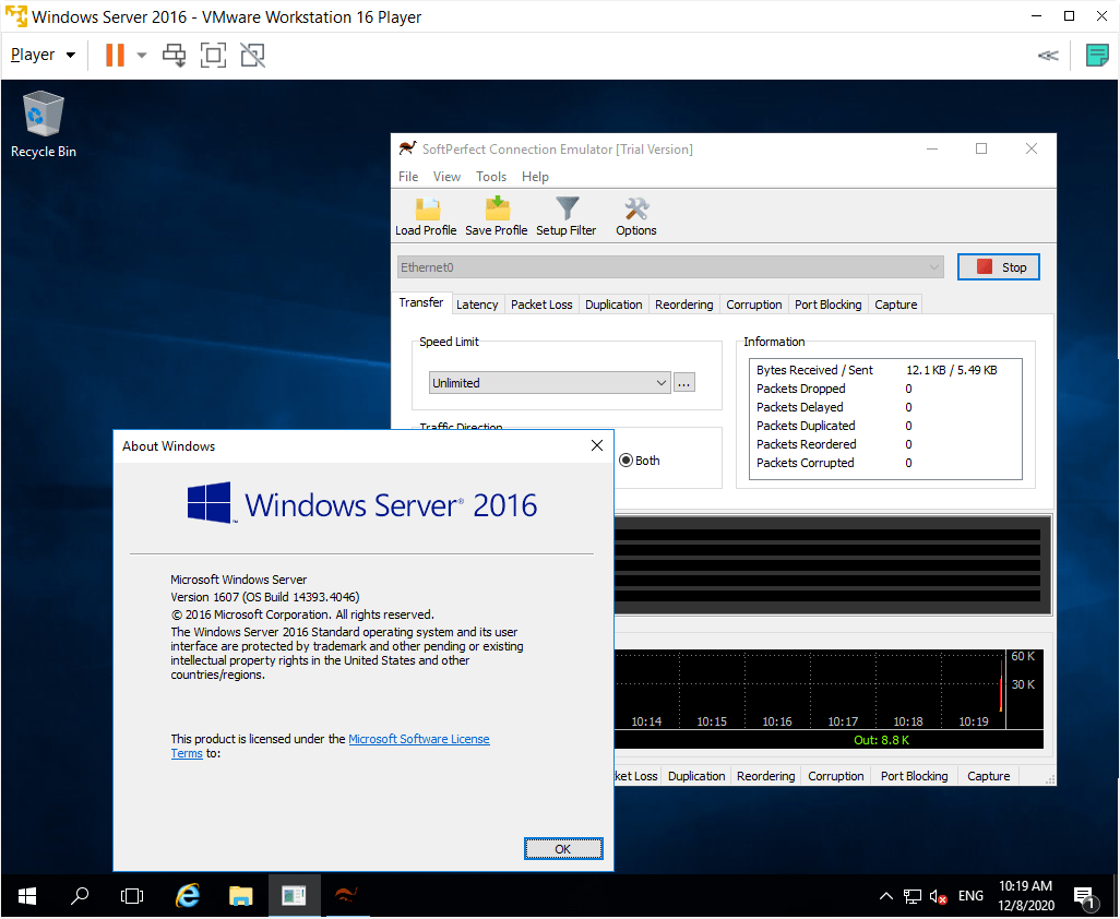

Re: "Failed to setup system event" error when starting emulation   08 December 2020, 10:25
We have a new build with updated drivers available for download on our pre-release page. Below you can see that build running on Windows 2016 Server in a VMWare VM.
If the issue persists, please try using the Connection Emulator on a fresh installation of Windows, as advised above. This will ensure no leftovers from older versions are present.
Good news! I can confirm the linked version is working perfectly. No errors experienced and the latency/jitter emulations are working well.
I can also confirm this was tested on a VMXNET3 configuration as well. I haven't yet had a chance to go back to the E1000E network adaptor.
