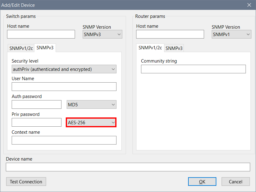

Re: Suggestion: Add AES-256 support - Done   05 February 2020, 17:56
Update: we have fixed the "division by zero" issue and implemented AES-192 and AES-256 support (this is likely to work with Cisco devices only, since it's not a part of the standard). Until the next official release, you can download the latest build here.
