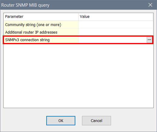

Yes, it's possible - please see this article: Configuring SNMP MIB query for MAC address resolution.
Basically, before running a scan, Network Scanner queries ARP caches from the configured router(s). Then when scanning, it matches the IP-to-MAC lookup tables to resolve MAC addresses outside the current subnet.
At the moment only SNMPv2c and SNMPv1 are supported, though we can easily add SNMPv3. You may also have to set the Router SNMP MIB query option to priority 1, to ensure it's prioritised over a regular ARP lookup.

We have just added SNMPv3 support in MAC address resolution with SNMP. The new builds can be downloaded here.
Regarding having own router settings per subnet, that's a little challenging to do in the current implementation. Instead you could either:
  • List all your routers there, in which case the app will fetch ARP caches from all of them. There is no downside to that, except for a longer time spent before scanning, to fetch the mappings; or
  • Create individual config files for each subnet. In this case you can configure specific routers to be used, as well as any other settings specific to each subnet.
