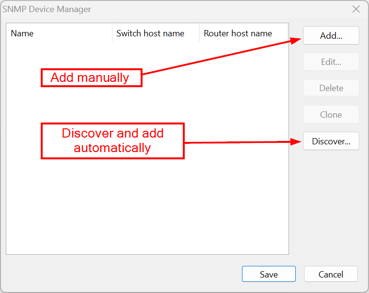

In the SNMP Device Manager:
  • click Add to add a device manually, or
  • click Discover to scan the network and add devices automatically.
