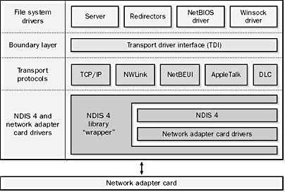

It is hard to tell what's happening in your system. We also don't have MS Vista for tests due to its insignificant market share.
Now, if we install WinPCap latest version (allowing it to start automatically) and NetWorx, it all works correctly without administrative privileges or elevation. Here I have opened NetWorx settings after a reboot:
As to why the interface selection changes to All Connections, you might have noticed that it becomes disabled. This is because NetWorx's own traffic filtering driver operates at a higher level (called TDI) than WinPCap does (called NDIS). Here is a diagram illustrating this:
Now, at the TDI level there is no "network adapter/interface" as such, since routing is done at a lower level. In other words, a choice of network interface is meaningless when the Ignore LAN traffic checkbox it ticked.
