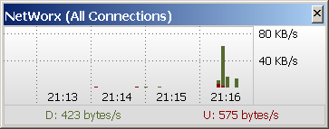

If that's not available, another workaround might be to set the poll interval to 5000ms and then configure NetWorx to interpolate the data. To try the interpolation, go to the NetWorx's Settings - Graph - Graph Type and set it to Columns. After that, open the hidden options and set Mean Samples to 5. Then it should interpolate data from each last 5 seconds as shown below:
