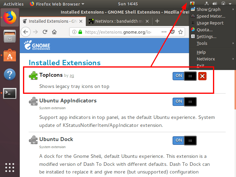

Re: How to launch on Ubuntu 18.04 LTS   07 June 2018, 13:52
NetWorx requires the TopIcons GNOME extension to be installed as shown below. Once installed and rebooted, it should appear in the notification area.

Re: How to launch on Ubuntu 18.04 LTS   08 June 2018, 11:55
thank you! don't know how i missed that.
