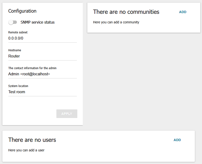

I am trying to set up router monitoring via SNMP in NetWorx. My router (D-Link DIR-825ACG1) has support for it. I have the option to add SNMP communities and users. But I don't know what to add. The router's manual doesn't say anything.

SNMP is usually more reliable in this regard. To enable it in your D-Link router configuration, most likely you just need to flip the switch next to SNMP service status to the 'on' position. Then add a single community with the name public. If asked about read/write rights, choose read-only.

I did what you suggested. I'm happy to report back that it worked. Networx provided a large list of WAN interfaces to choose from, so I trialled-and-errored my way to the correct interface. In this case, the correct one was "eth1". (There was also "eth0", but it seemingly swapped upload and download rates.)
