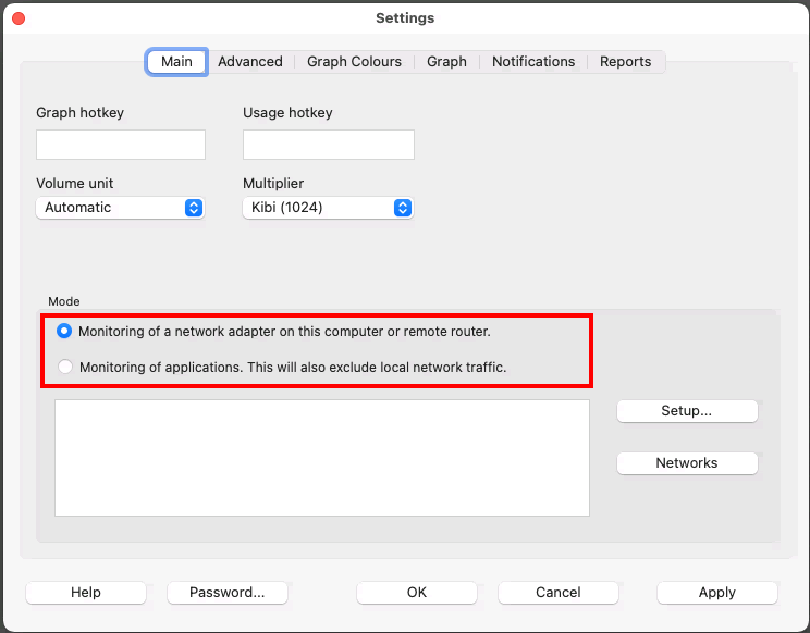

It's probably a bug. Please confirm which monitoring mode you are using: adapter or applications, as shown below?
These two options use different data collection methods, so we will know where to look for the bug.
Re: App randomly closes on macOS   13 February 2022, 18:52
I have the mode set to Monitoring of applications.
