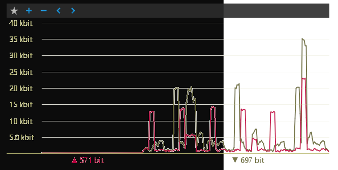

Re: NetWorx version 7   07 May 2022, 10:58
Was the graph transparency feature discontinued in version 7? I have used this feature in the past, are there any plans to bring this feature back?
Re: NetWorx version 7   07 May 2022, 11:02
The graph transparency is unfortunately incompatible with the anti-aliased drawing that is used in v7. As the graph lines and text are now drawn with antialiasing and blended with white background by default, it all looks good when the window behind is white, but otherwise it does not:

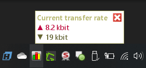

Good Morning,
I've just upgraded to version 7, and while I like the update, but I'm no longer able to see the current transfer rate when I hover the mouse over the tray icon like I could in version 6. Is there a setting to enable this somewhere or has this feature been removed?
Thanks,
Scott
Re: NetWorx version 7   07 May 2022, 11:13
The display of the transfer rate on mouse hover had to be removed because it did not work well with some versions of Windows.
However, you can assign the transfer rate display to the left mouse click, with the subsequent left click closing the pop-up:

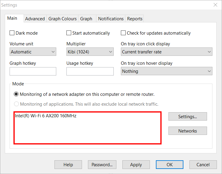

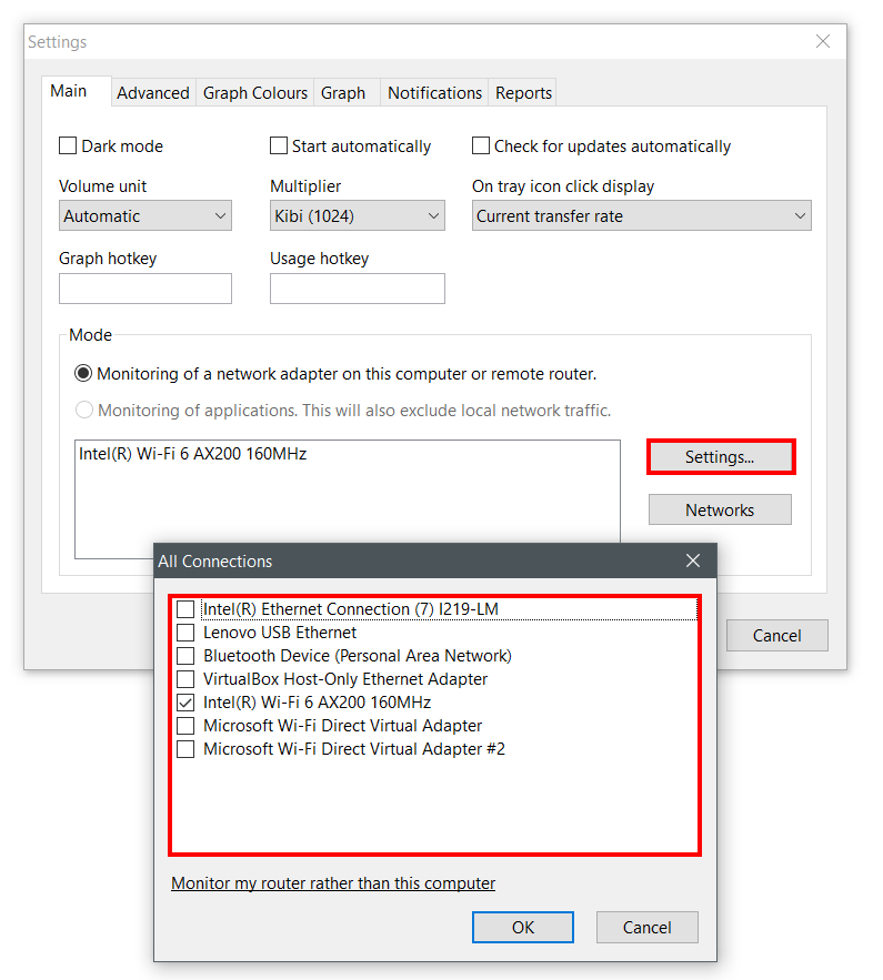

I installed Networx 7 a few days ago. Made a few changes including On tray icon click display changed to Usage graph. Was working OK for awhile. Then, the graph stopped showing. Realized my license was not used (still running trial version). Pasted license in. Still no graph. Clicking the system tray Networx icon does nothing (no graph). The right-click menu on the system tray icon has Show Graph disabled. I tried re-installing 7 again and re-started. Still no graph. Also, version 6 had an option to show summary totals in the graph. Have not found a way to show that in version 7. Are there any steps to restore graph functionality? Have not gone to version 6 yet. Thanks.
Re: NetWorx version 7   09 May 2022, 15:25
This suggests that the ID of your network adapter may have changed. Kindly try clicking the Settings button and choosing a network adapter to monitor:

Bob Kaiser
Re: NetWorx version 7   10 May 2022, 09:13
Thanks, that was the fix. For some reason, after changing settings, I had no adapter selected. Graph is available now.

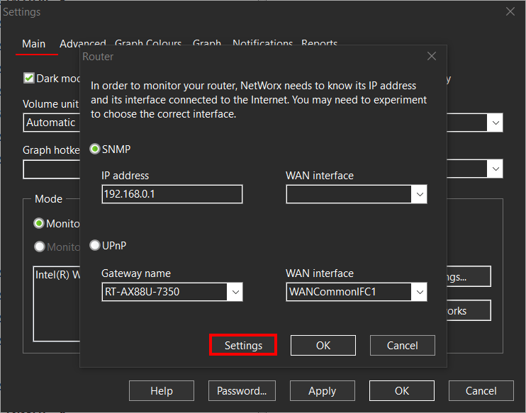

Re: NetWorx version 7   15 May 2022, 19:13
Asus router was monitored via SNMP with no issues with the previous version. I have ensured that the right interface is selected as SNMP monitoring is working with no issues on my Mac. "Show graph" displays no traffic whatsoever. Any assistance would be appreciated, thanks.
Re: NetWorx version 7   15 May 2022, 19:32
With ASUS, it is probably related to the fact that NetWorx v7 defaults to SNMPv2, which uses bulk requests that may not work well with some devices. We'll check this out and publish an update soon where you will be able to choose a specific SNMP version.

Re: NetWorx version 7   17 May 2022, 15:39
We have updated the SNMP implementation and it should now work with any device that supports it. It is also possible to choose a specific version of the protocol, so you can choose 1 or 2 to see which works.
The latest builds can be downloaded here.

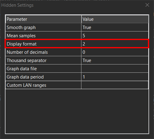

The latest build now has me up and running again, thank you. I'm not sure if I've missed something new with v7.0 or in the settings, the scaling displayed doesn't go down into KB/s regardless of what's selected in the settings. Essentially, I'm trying to recreate the same functionality as the previous version.
Re: NetWorx version 7   18 May 2022, 23:12
For that there is a separate setting that is in the hidden settings. Simply press Ctrl + O (letter) in the Settings window and change Display Format to any of the following:
  • 0 for automatic
  • 1 for kilobits/kilobytes
  • 2 for megabits/megabytes
  • 3 for gigabit/gigabytes
Update: in version 7.1.1 this became the Speed setting on the Main tab in the ordinary Settings.

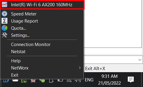

I just upgraded to v7.0.1 and the "Show Graph" option is missing when you right click on the tray icon. I re-installed it, rebooted my Win10 PC, but still no "Show Graph" option. What happened to it?
Re: NetWorx version 7   21 May 2022, 09:35
As many users requested, the Show Graph menu was removed, and now the graph can be open by clicking an adapter name directly in the popup menu:
If this item is not present, please check the list of monitored adapters:
