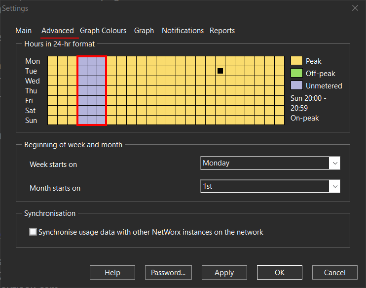

By the way, it's probably not necessary to reset it each month. Instead, you can align NetWorx reporting with your ISP billing period by using the Month starts on setting on Advanced tab in Settings. This way, one month in NetWorx would match one month of your ISP.

My ISP (Viasat) gives me a free time from 3 am to 6 am that doesn't count to my data cap or speed limit. Is there any way to not count those times? Just curious, not sure that I should not monitor that time anyway.
Thanks again and if you don't want to answer the last question, that is fine.
Cheers!
David
Re: Excluding certain times from being counted   01 June 2022, 12:22
That can be easily done. You can mark the 3am to 6am hours either as 'unmetered' or 'off-peak', depending on your personal preferences.
The 'unmetered' times are not shown in reports (but are still recorded), while the 'off-peak' periods are recorded and shown separately from peak times. You can change this setting at any time, and it will update your reports accordingly.
