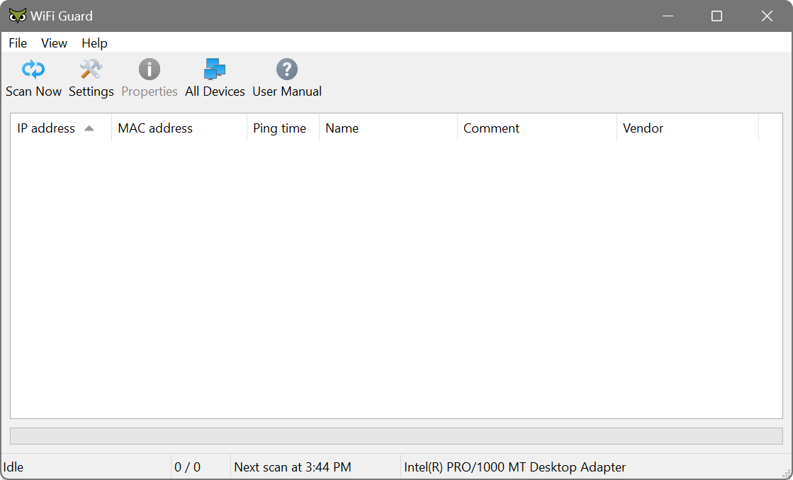

If you have only one adapter, the configuration dialog will not be displayed. Instead you will be presented with the main application window:
SoftPerfect WiFi Guard main application window
Main application window
The columns display IP and MAC addresses of the detected devices, ping time that shows how long it took the device to respond, automatically detected device names, comments that were added for each device, and the device vendors or hardware manufacturers.
Here you can click the Scan Now button, open the Settings, check the Properties of the selected device, or see All Devices ever detected.
If the Scan Now button is disabled, it means that either your network connection is inactive, or an incorrect adapter has been selected. In this case, click the Settings button and try selecting a different adapter from the list.

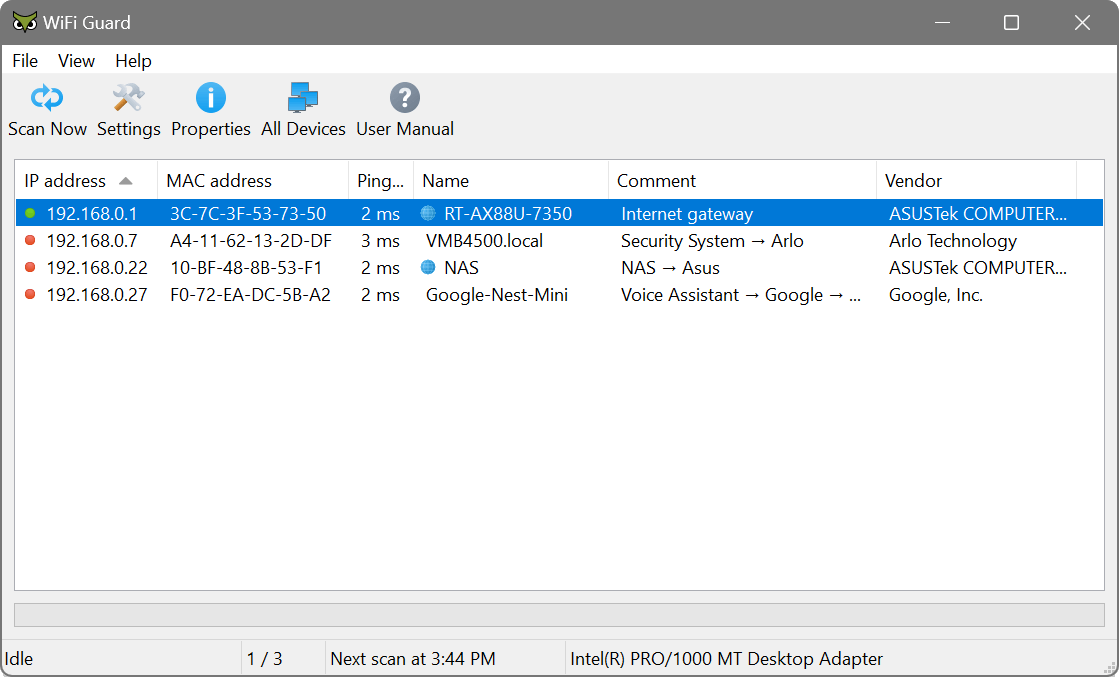

Click Scan Now to detect all your network devices. This will scan your WiFi network and display what is there. It may take some time, depending on the size of your network.
Once the scanning process is finished, you will see a list of devices, including your computer, your router and possibly some other devices. Your computer and your router will be marked as “known” (green) straight away, because WiFi Guard already knows they are legitimate. The devices marked “unknown” (red) represent everything else: other computers, smart phones, TV, Xbox, etc. They are red because WiFi Guard doesn’t know yet whether they have your permission to connect to your network.
SoftPerfect WiFi Guard scan results example
Example of scan results in a small network: one device was automatically marked as “known” and the other three as “unknown”.

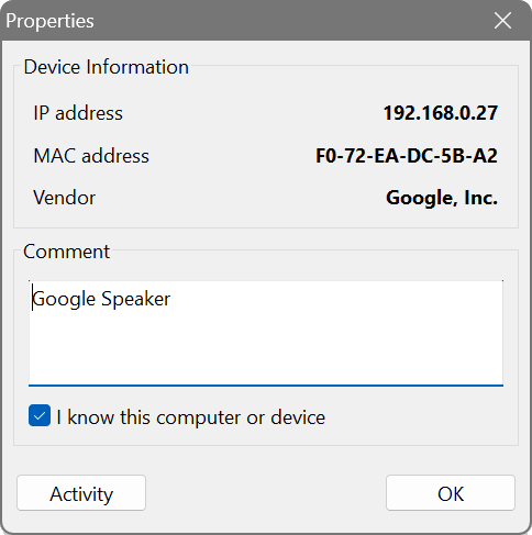

Identifying your devices
The whole idea of WiFi Guard is that you mark all your devices as “known”, and this will allow you to spot new devices in the network that are not yours or should not be there.
Double-click each unknown (red) device and mark it as “known” if you recognise it. You can also add a comment for convenience:
