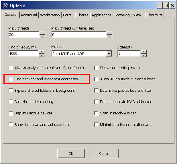

I keep forgetting to let you know that NetScan will not let me enter 162.213.122.82 /32 as a valid search. I have to put 162.213.122.82 to 162.213.122.82 to scan a single IP. Thanks -WindowsStar
Re: Not accepting /32 address as a valid CIDR range   30 May 2018, 15:17
That's because in a single-address CIDR block that IP address would also be the broadcast address.
This IP calculator likewise treats the IP address as broadcast.
You can simply tick the option shown below and /32 addresses should be accepted normally:
Re: Not accepting /32 address as a valid CIDR range   31 May 2018, 00:50
Yup, that works.
Thanks for the link. Picture worth a thousand words.

Re: Not accepting /32 address as a valid CIDR range   31 May 2018, 10:16
The button is sort of already there wink Simply add your CIDR range:
Then click the arrows to convert it to a plain range, in which there is no broadcast address.
Should you need the CIDR back, just click the same button again:
Re: Not accepting /32 address as a valid CIDR range   01 June 2018, 12:22
smile That is the button I am using that doesn't work because I have to toggle the checkbox for broadcast/network scanning you mentioned. That is why I suggested the new icon. Right now it is three or four mouse clicks to turn it off ... then three or four to turn it back on. The new icon would do all the mouse clicks for single IP? Just a thought nothing that has to be changed... and again you may have a more elegant way of doing it.
