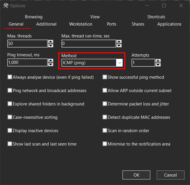

This would be because your computer with Network Scanner is outside the current subnet; that is, not in 10.20.157.x. In such case, the default gateway responds to every ARP request with its own address and routes connections through itself, which confuses the software.
Try setting the ping method to ICMP only on the General tab in Options. This should eliminate all those "ghost" devices.
