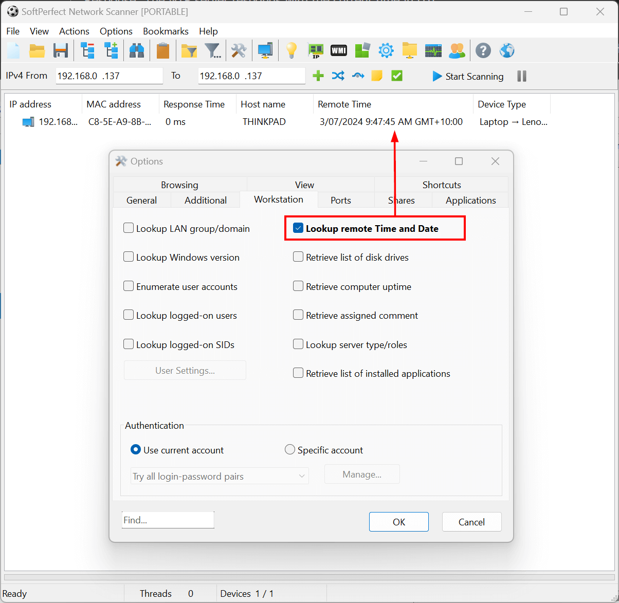

It depends on what other services are available and whether the server is part of a domain. You can try selecting "Lookup Remote Time and Date" on the Workstation tab in Options.
We have also updated the application, so it now displays remote time received from NTP servers in the local time zone. This should make the application more user-friendly. Please download the latest build to see the changes.
