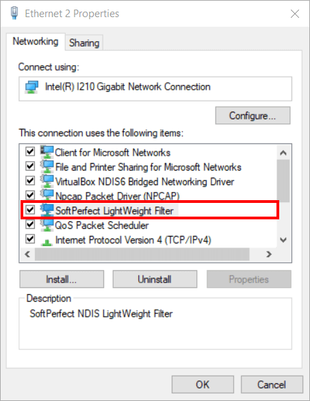

Theoretically you could try unbinding the driver manually from network connections. For this, please access the Properties of each network connection and uninstall the driver as shown in the screen shot below. Then remove the software itself via Add/Remove Programs.
If that does not help, it may be easier just to keep the software in the system. It does not consume any resources when not used, and takes very little space.
