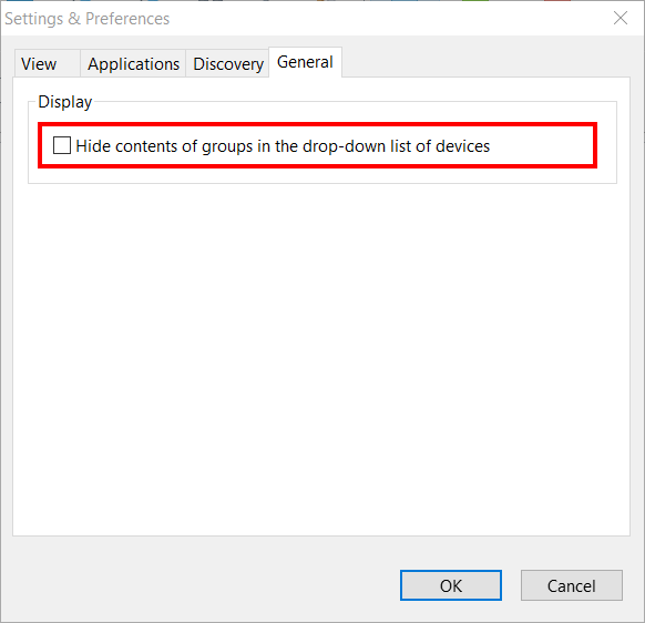

  • Added a new setting that allows you not to display individual devices in groups in the drop-down list.

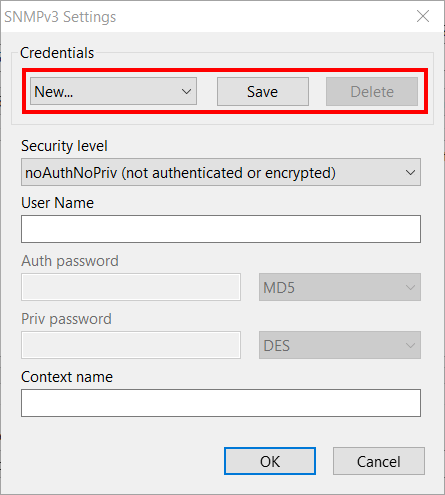

  • The SNMPv3 discovery settings now support profiles, so you can define several sets of SNMPv3 settings.

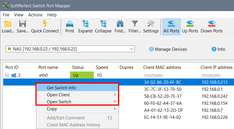

  • Added new items to the pop-up menu: Open Switch and Get Switch Info.
The Get Switch Info menu item lets you see the switch properties, including its model name, directly from any row. You can choose a line and get the details about the switch associated with that line. Likewise, the Open Switch menu item lets you launch Putty or any other application against the switch associated with the selected line.
When using the Open Switch menu, the %0 argument is replaced with the switch IP address. When using the Open Client menu, the %0 argument is replaced with the client device IP address.

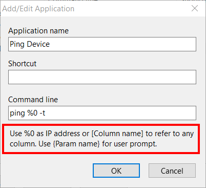

I know this next bit is way beyond the scope, and probably something I can take further, although it is a little out of my comfort zone... I'm now trying to find out if I can run a command against an interface to say change vlan or shut/unshut. So far, I've found this, which should change it to UP:
snmpset -v1 -c community hostname IF-MIB::ifAdminStatus.interface i 1
Hostname would be the %0 and "interface" would be the port ID, so would it be possible to offer up the port ID as an option to insert e.g, %1? So in theory:
snmpset -v1 -c community %0 IF-MIB::ifAdminStatus.i%1 i 1
I'm hoping that I could then develop scripts or various commands to perform specific tasks to interfaces, just to speed up certain tasks.
Thanks again for all of you work, it is really appreciated!
Re: New features: groups, profiles, get switch info, command line parameters   27 October 2020, 15:08
That should be possible now: we have just added a way to refer to a column and pop up a user prompt, in the same way it's done in our Network Scanner.
Here is the screen shot and the new build:
Please let us know how this works for you. You should also be able to run any scripts, e.g. Python or VBScript.

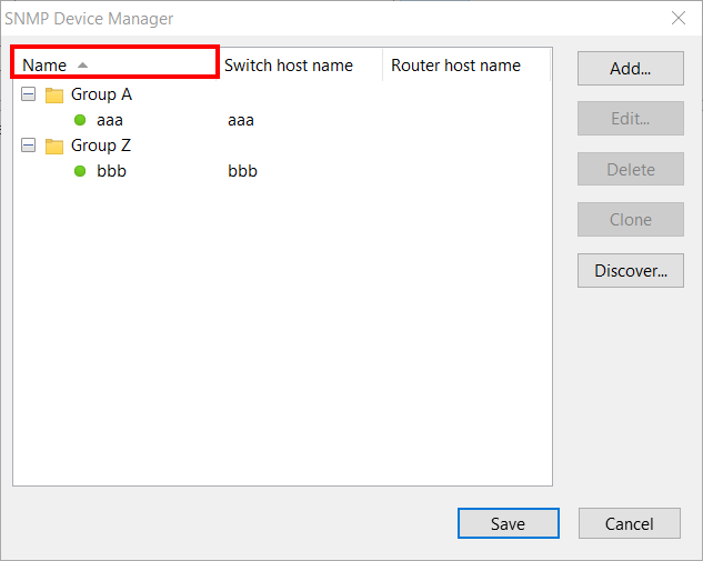

Could you make the list of groups appear in alphanumerical order? I think they just appear in the list in order they were added. We are likely to have around 80+ groups, so having them in some order would make finding them much quicker!

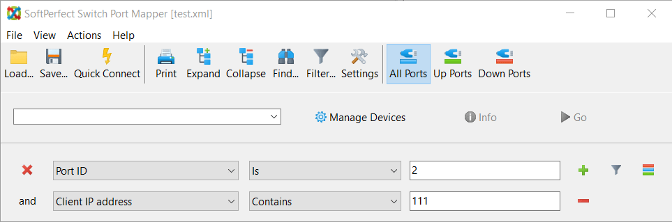

Is it possible to be able to have more than one filter, as in the Network Scanner?
If we need to go back to an existing group of switches to add an additional, could we have an option to rescan the group without having to re-enter all of the network info again? I noticed that I can select an existing target group, but it still requires manual input of associated settings for that group.
Thanks again!
Re: New features: groups, profiles, get switch info, command line parameters   19 November 2020, 22:43
Thank you for your feedback. In order to sort the groups and switches alphabetically, simply click the heading in the device manager as shown below. They will be sorted alphabetically and this will also apply to the drop-down list in the main screen.
Regarding multiple filters, sounds like a good idea. We'll do that shortly.

We have just implemented multiple filters support as shown below. The new builds can be downloaded here.

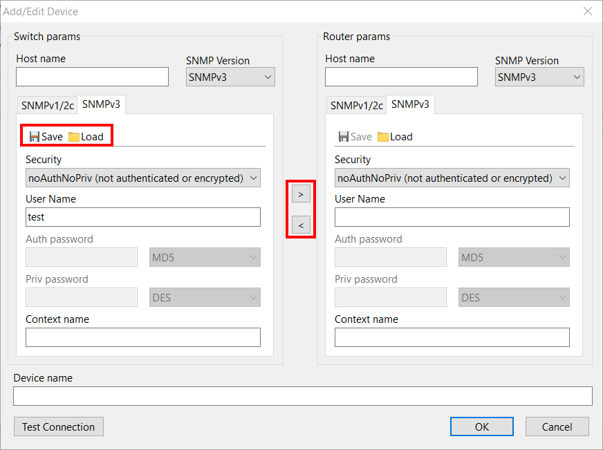

Perhaps to make adding a single device a little easier, would you be able to offer the SNMPv3 profiles into the Add Device section, or perhaps even an option to duplicate the SNMP info between switch and router?
Have a great weekend!
Re: New features: groups, profiles, get switch info, command line parameters   23 November 2020, 21:50
Sure, sounds like a good idea. Done both and the new builds are available here.
  • SNMPv3 profiles support in every SNMPv3 input pane.
  • A couple of buttons to copy switch settings to router settings and vice versa.

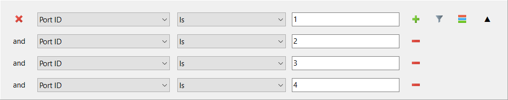

Would it be at all possible to be able to hide/minimise the filters once applied, to allow for more information to be displayed in the main list? We quite often have several filters in play, which can occupy quite a lot of space.

We have just added a button to fold/unfold the filter pane when multiple conditions are present. It looks like this when unfolded:
and like this when folded:
It also shows how many filters are hidden.
