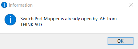

We have updated Port Mapper, and now the portable version can be safely shared over network. The new build can be downloaded here.
Simply place it in a writable network folder, and it should handle concurrent access correctly. Opening the first instance will create a lock file. Opening a second instance will result in a message like shown below.
Please note that it must be launched from a shared folder. If it's launched locally, it will still allow more than one instance.

Hi, I was reading an old post about multi-user access to see if it would be possible to share the config database among a couple of network engineers. I don't understand what was given as a possible solution:
"Simply place it in a writable network folder, and it should handle concurrent access correctly. Opening the first instance will create a lock file. Opening a second instance will result in a message like shown below.
Please note that it must be launched from a shared folder. If it's launched locally, it will still allow more than one instance. "
I don' t understand how those two sentences are not opposites. If the first instance creates a lock file and this causes the second instance to show a message that it is already opened, after clicking on OK the application closes. How can you still "launch locally and have more than one instance?
Do you mean multiple users launching the application from a shared folder, but all from the same shared pc, each from their own profile on this pc?
Kind regards, Bartel Onzea

The current implementation is like this:
The installed version keeps all data and settings under the current user profile, typically in C:\Users\user-name\AppData\Roaming\SoftPerfect\Switch Port Mapper. Since the config is stored in the current user profile, sharing is not possible. Multiple instances are allowed, but each instance will overwrite the config file upon exit.
The portable version keeps all data and settings in the folder it's launched from. It behaves differently depending on whether it's launched locally or from a network path:
Perhaps you have some suggestions on how we can better implement multiple instances and config sharing?
- When launched locally, multiple instances are allowed, but each instance will overwrite the config file upon exit. So if multiple local users start multiple instances, some settings may be lost. Example: users A and B both start the app at the same time. Then user A changes something and closes the app. After that, user B closes the app and his config will overwrite the changes user A made.
- When launched from a network path, multiple instances are not allowed to prevent config file overwrite. Example: user A and B start the app at the same time. User A will succeed, while user B will receive a message that user A currently has the app open. User B will not be able to start the app until user A's instance quits. This ensures only one user at a time has the app open and the config file doesn't end up overwritten.
