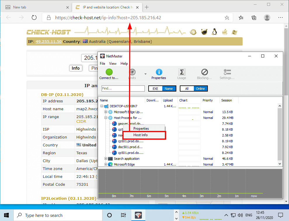

With this in mind, we have extended NetGenius and you can now add custom commands, which can be executed directly from the application. These are defined in the registry at the moment, so you will need to import this REG file and download and install the latest build of NetGenius.
After that, you will have a new menu item in the connections menu and will be able to open check-host.net directly with the current IP address passed to it. It should look like in the screen shot below.
