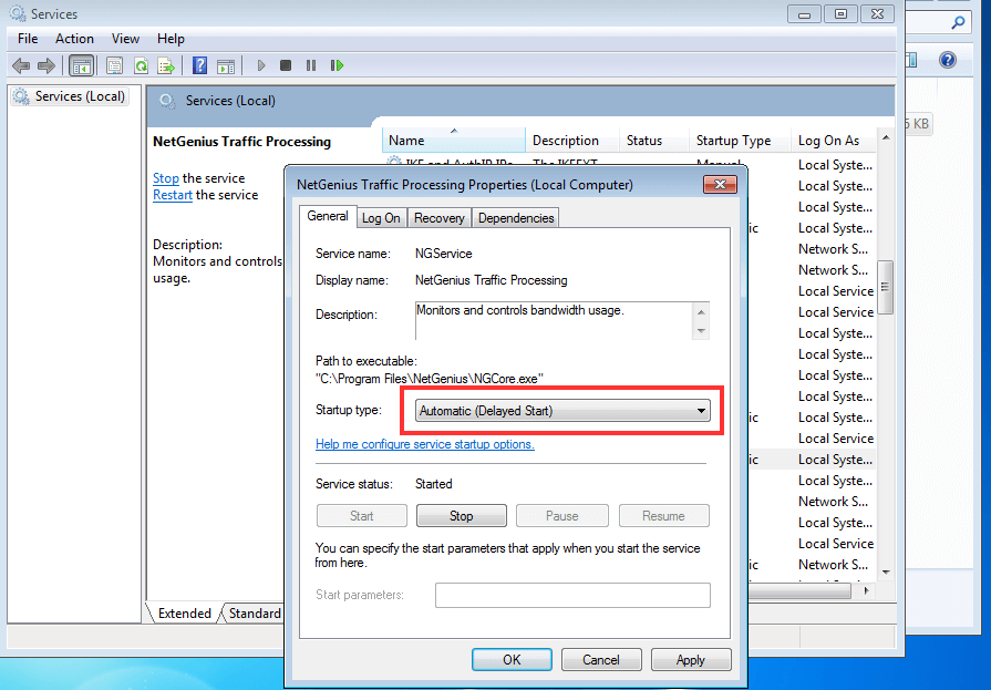

Re: Module NGCore.exe error   14 July 2021, 15:35
Unfortunately there was nothing useful in the log. However, since you said it worked fine once after a reboot, it may be another service or start-up activity that conflicts with NetGenius.
Try going to the Services control panel and changing NetGenius service Startup type to Automatic (Delayed Start). This will start the service a little later after a reboot and hopefully fix the issue.

Re: Module NGCore.exe error   14 July 2021, 15:40
Thank you!
I tried it, but it did not help. Maybe I should go through the list, turn off services one by one, and see if I can find the conflict?

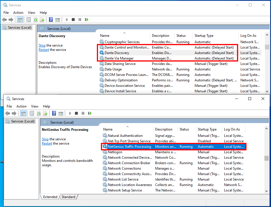

Re: Module NGCore.exe error   14 July 2021, 16:10
Thank you for the information. It is indeed the case: somehow Dante service conflicts with NetGenius network driver.
It seemingly depends on the order they are started in. We were able to set Dante services to be launched as delayed, while NetGenius service starts without delay. Rebooted a few times for testing, and everything worked well every time.
Please try configuring the three Dante services to be delayed and NetGenius service not to be delayed. This way our NetGenius will start before Dante and both seem to work fine then. Below is a screen shot of this configuration.
It may take us a while to get to the bottom of this issue, but this should be a valid workaround for the time being:
