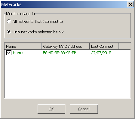

If you want to keep separate usage records for each place, I am afraid this is not supported. However if you only want to monitor usage at home and ignore usage at any other place, there is a setting in NetWorx just for that.
Simply go to the Main Settings. You will see a button titled Networks, which lets you exclude certain networks from monitoring. It detects all networks that you connect to and identifies them based on the MAC address of the default gateway. So you can instruct NetWorx to only monitor your usage when connected to the home network:
