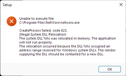

NetWorx does not start. I get this error on my Windows 11 x64 21H2. I've tried numerous versions they all come up with the same error.
Unable to execute file:
C:\Program Files\NetWorx\networx.exe
CreateProcess failed; code 623.
{Illegal system DLL relocation}
The system DLL %hs was relocated in memory. The application will not run properly.
The relocation occurred because the DLL %hs occupied an address range reserved for Windows system DLLs. The vendor supplying the DLL should be contacted for a new DLL.

That's really odd. I can only think of the relocation table that we strip from EXE files to reduce their size. This may cause issues when running NetWorx in a sandbox or similar isolated container.
Kindly try the latest build with the relocation table intact and let me know if this works for you.

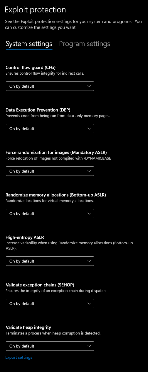

I suspect the global exploit protection I have enabled in Windows may have played a role in this:
Re: Program fails to load "CreateProcess failed; code 623. Illegal system DLL relocation" - Fixed   08 November 2022, 19:32
Yes, it's the Mandatory ASLR that needs to relocate the EXE image in memory.
Thanks for letting us know. Relocation information will now be included in all future builds.
That is what I suspected. I've been wanting to use NetWorx for a year now. I really appreciate that. Thank you for patching it up and increasing its security.
