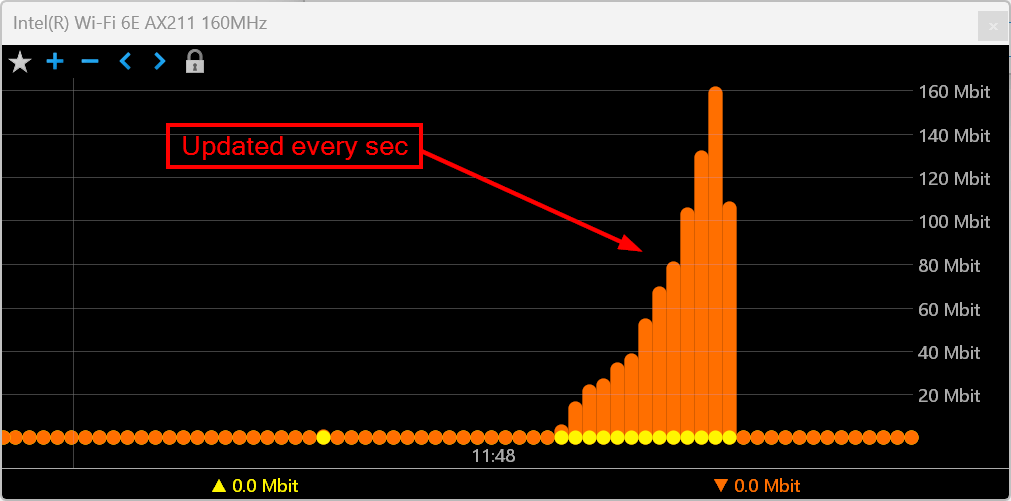

If you'd like to have thicker bars visually moving at a faster rate so that any unexpected usage spikes can be easily seen, we've just added a new hidden setting that allows you to control it. It's called Graph line step and can be set to any number between 1 and 10.
Roughly speaking, it's the size of each logical bar in pixels, so if you set it to a higher number, and choose 'Histogram' as your graph type, you will see a shorter time period on the graph, but with thicker lines.
Please download the new build, set your graph to 'Histogram' and change 'Graph line step' in the hidden settings. This also affects 'Polyline' and 'Columns', so feel free to experiment with it.

The column chart is designed to show averaged values over N seconds, which is intended for users who prefer fewer animations and are okay with the chart being N seconds behind real-time. It won't function correctly if you have 0 or 1 samples, because with 0 or 1 samples there would simply be nothing to average. It needs a minimum of 2.
If you want a real-time chart that resembles columns, we recommend using the Histogram mode and setting the graph line step to 10 or so. This will result in a histogram with ticks that are roughly (depending on your display PPI) 10 pixels wide, which should give it a bar chart appearance:
