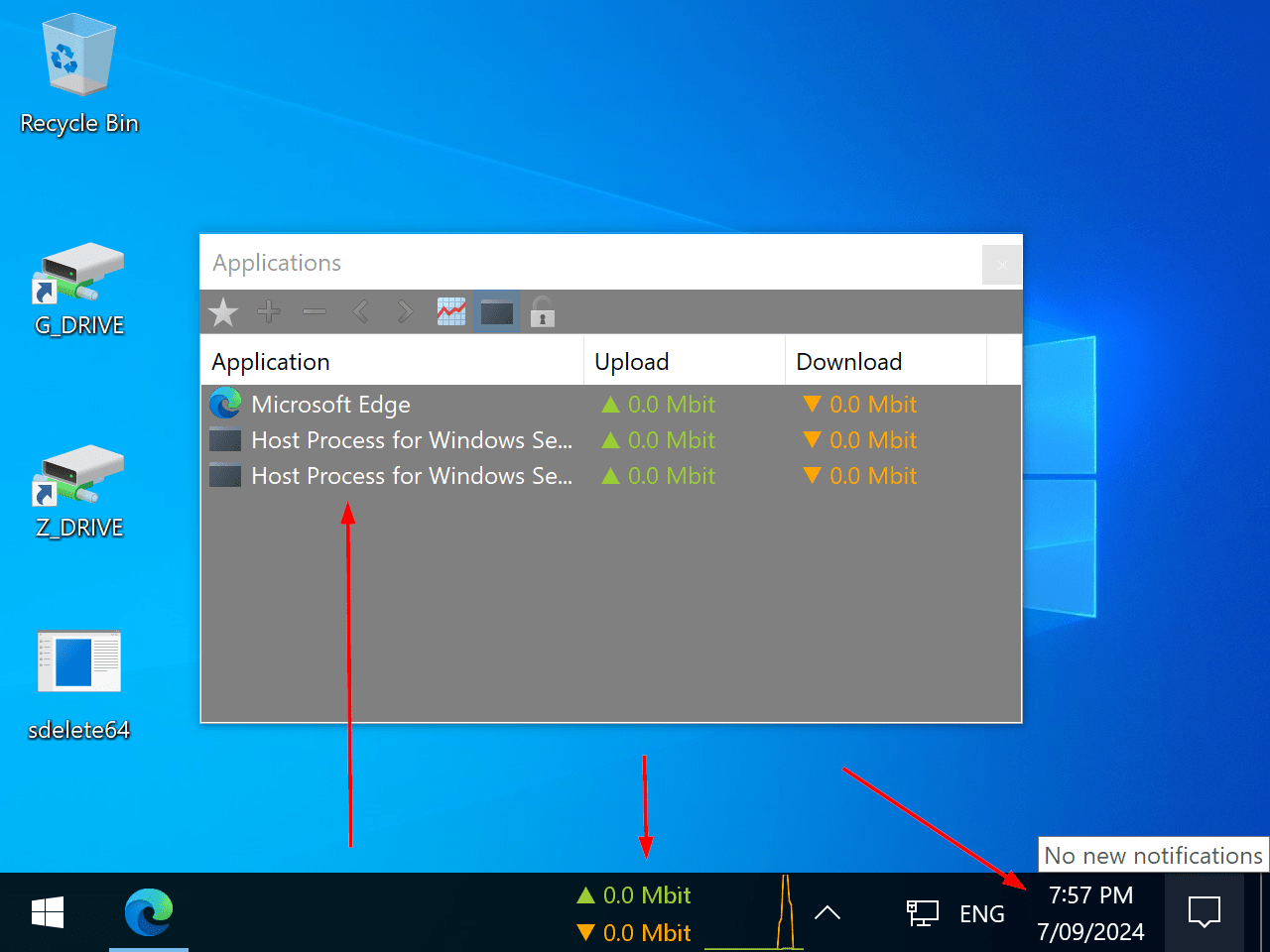

Could you let me know what your system DPI settings are?
The application is designed to scale automatically based on your system settings, including DPI, so it should adjust with the rest of your system fonts. Here's a screenshot showing how it should appear.

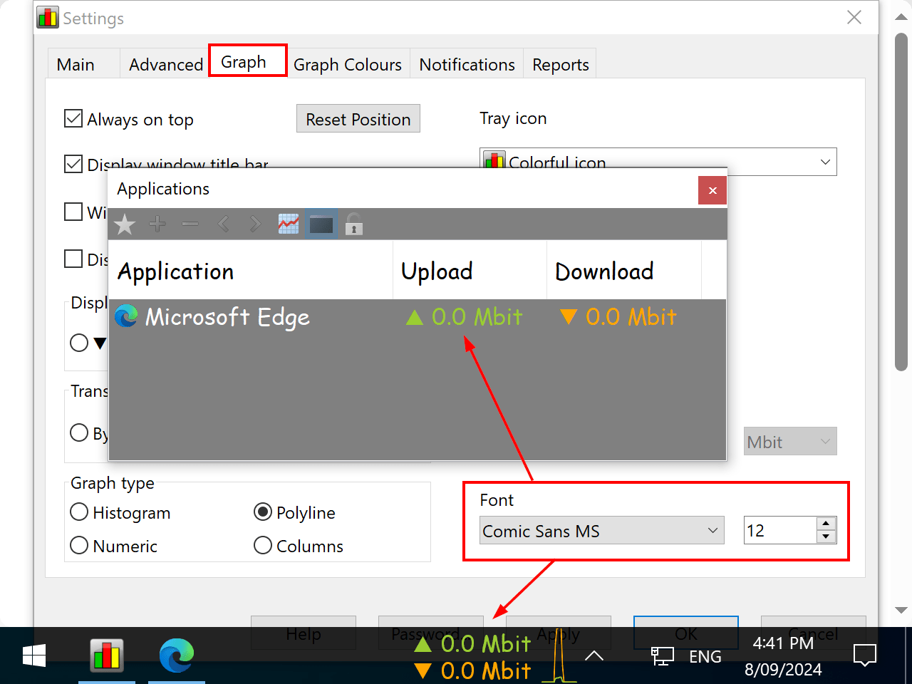

This is quite unusual, and we are not sure why the Applications window isn't scaling up as expected in your case. However, as a workaround and improvement, we have updated NetWorx so that the application view and popups now respect custom font settings, as shown in the screenshot below.
Please download the new build and let me know how it works for you. If the fonts are still small, you can manually adjust the font size in the settings:

Good morning, thanks for the update. I've just installed it and the text indeed now scales with the setting, the icon doesn't though. Also the text on the speed graph scales twice:
Applications
Graph

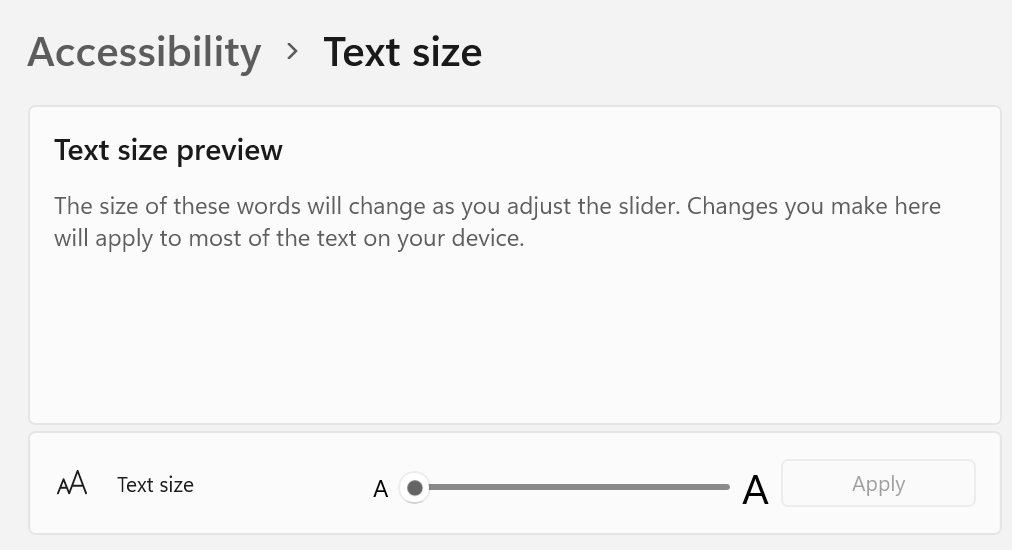

Do you have any custom settings under Accessibility - Text size in your Windows? This may be the cause of the problem:
Re: How to increase text size in Applications window   09 September 2024, 22:26
That was it!
I've installed the software on my other computer just now, and everything is fine. I've then tinkered with the accessibility tool and sure enough the text then became tiny.
I needed to set accessibility back to 100% AND reboot for it to work properly again, following the size settings in the Settings is the best result for me.
