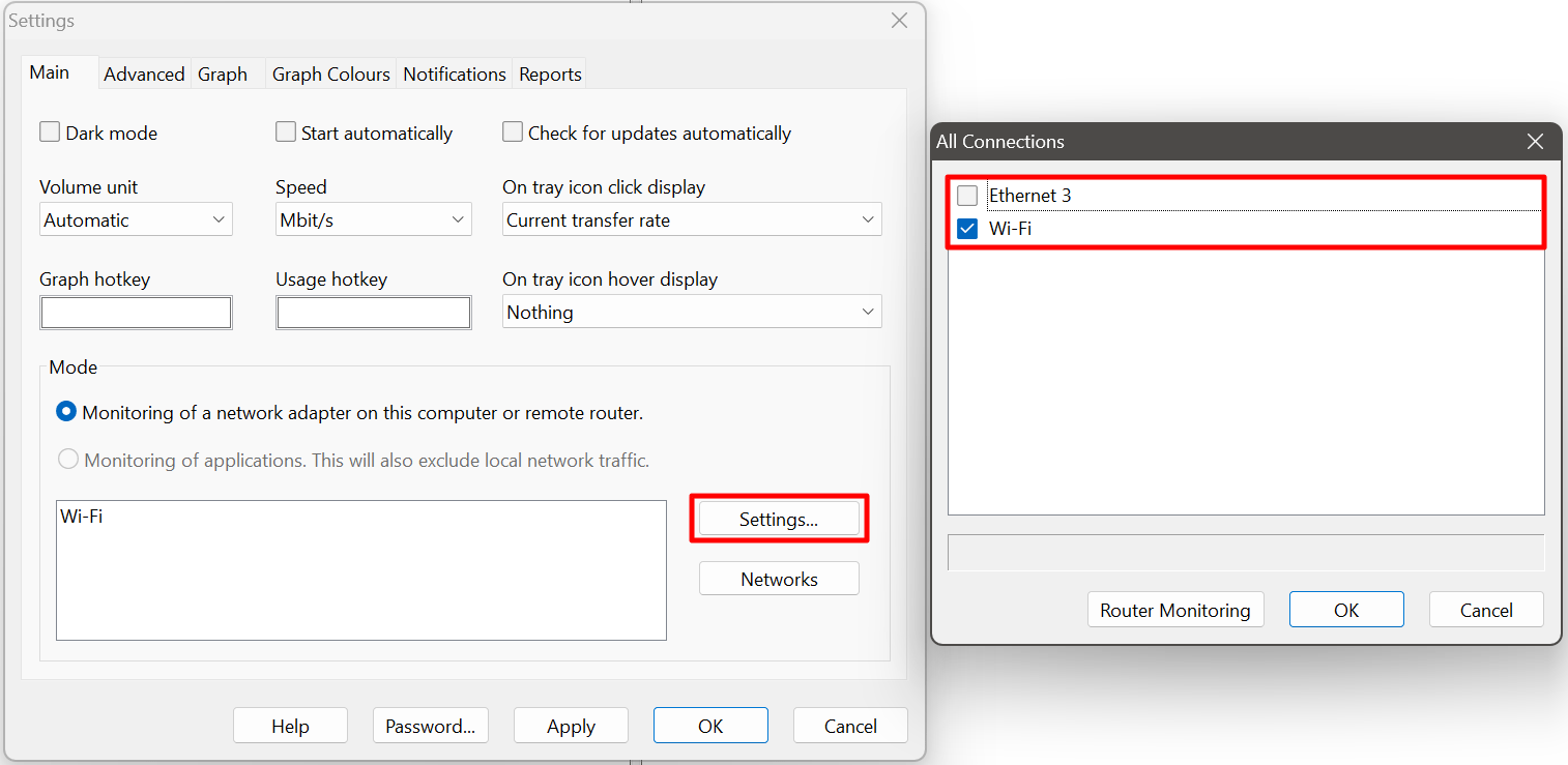

Re: Version 7.2.2 doesn't show any measurements   23 February 2025, 10:13
This issue is related to the fact that we have updated the adapter selection process in version 7.2.2. As a result, only online network adapters with a valid IP address can now be monitored.
To exclude any confusion with old adapter names, could you all please try the portable version? Launch it, open the adapter selection dialog, check all the adapters you wish to monitor and let us know how it works for you.
Example:
