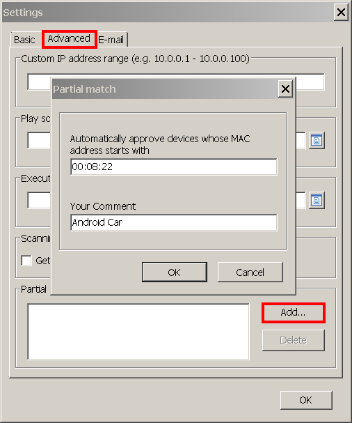

The Inprocomm device's MAC is the MAC-address of my car Android radio. It is establishing a connection to my router every time I start the car. And yes, the MAC address begins with 00:08:22, but the rest of the address changes every time.
I hope I helped.
Re: Unidentified Inprocomm device in my WiFi network   01 November 2019, 12:51
Thank you for sharing your discovery.
By the way, WiFi Guard can automatically approve devices with dynamic last 3 octets. All you need to do is to go to Settings - Advanced tab - Partial match field and add the unchanging first part of MAC to Automatically approve devices whose MAC address starts with:
