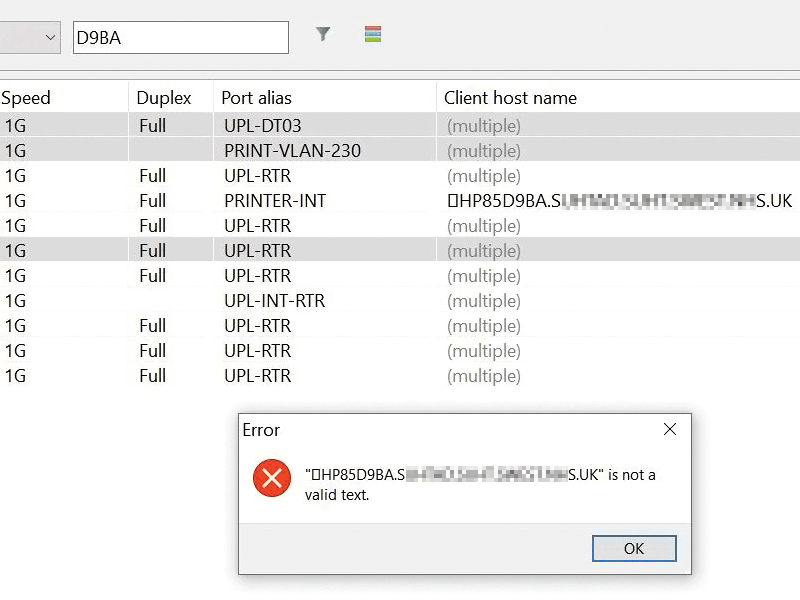

Not sure why, but there appears to be a random character in the hostname of a printer that is preventing me from saving a file. I get the "... is not a valid text" error. Can you do anything to ignore this at all, as it is preventing us from saving the results?
Many thanks!

Thank you for reporting this error. We have checked, and this is indeed the case. Erroneous characters cause the XML to be invalid, and the save operation is aborted.
Please try the new build. It writes XML in a 'relaxed' mode and invalid characters should no longer cause an exception.
Let us know how it works for you.
Yep, that fixed it... thanks!!
