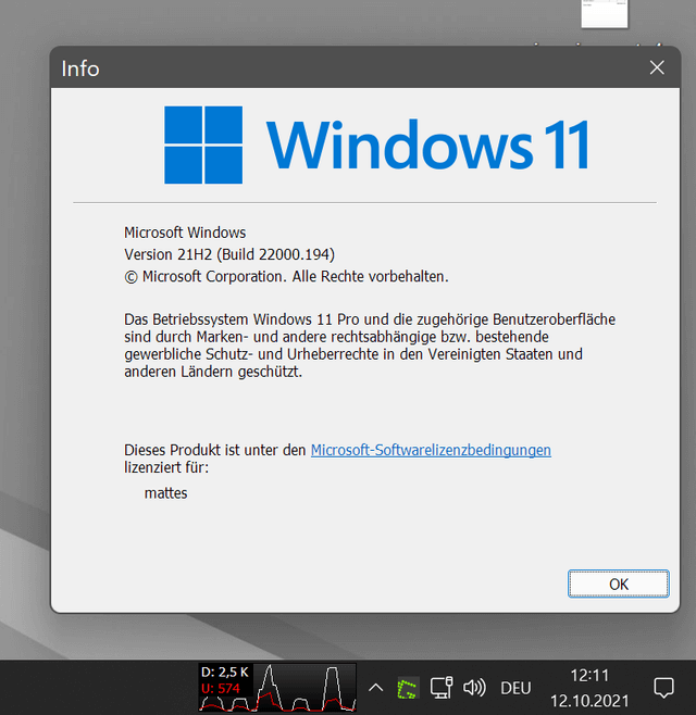

Restored taskbar on Windows 11 with StartAllBack   12 October 2021, 20:27
Works for me, but don't know why. Maybe because of startallback?
Re: Restored taskbar on Windows 11 with StartAllBack   12 October 2021, 23:31
Indeed, we have tested this setup and it works. Looks like StartAllBack either enables the old taskbar buried somewhere in Windows 11, or provides its own implementation. Either way, it does a good job of improving usability. Thanks for sharing this tip!
