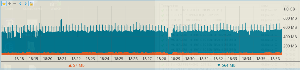

Graph has a problem: it shows repeated drops and spikes after changing the units from bytes to bits.

We would like to have a better look at your case, as in our tests the graphs look correct and identical:

I'm monitoring a 10Gbps link and the graph looks buggy. Other slower links are looking normal.
I'm using the latest licensed version of Networx. In old versions of Networx the graph looks normal on the same link.

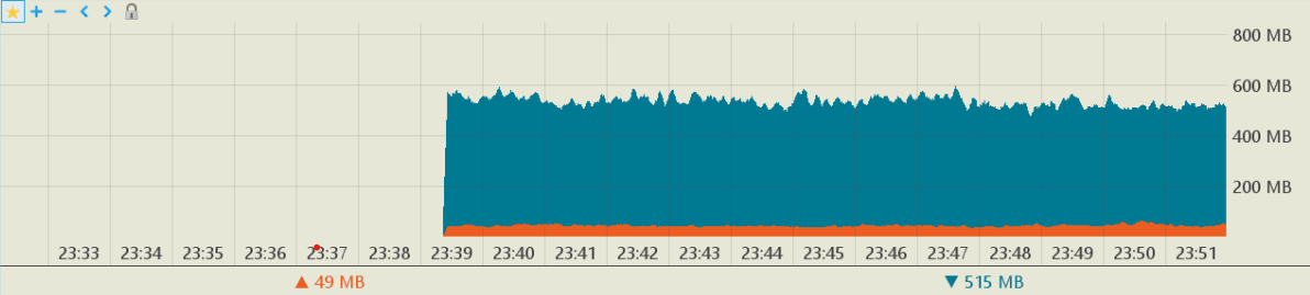

Still doesn't work sad

Looks like the new build only fixed the problem partially as the spikes present on the MB graph are gone:
We will have another look into the spikes on the Gbit graph - it definitely looks wrong.
