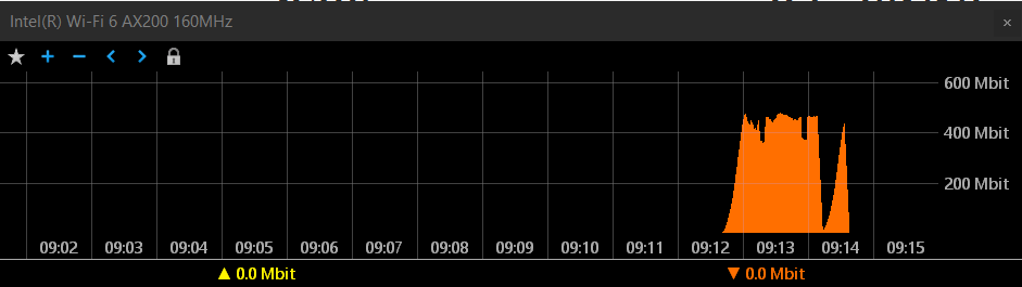

Repeated drops on the graph after changing from bytes to bits
Repeated drops on the graph after changing from bytes to bits   25 January 2023, 07:38
Graph has a problem: it shows repeated drops and spikes after changing the units from bytes to bits.

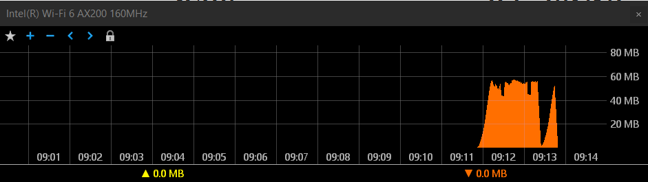

Re: Repeated drops on the graph after changing from bytes to bits   25 January 2023, 13:52
Looks like the new build only fixed the problem partially as the spikes present on the MB graph are gone:
We will have another look into the spikes on the Gbit graph - it definitely looks wrong.
